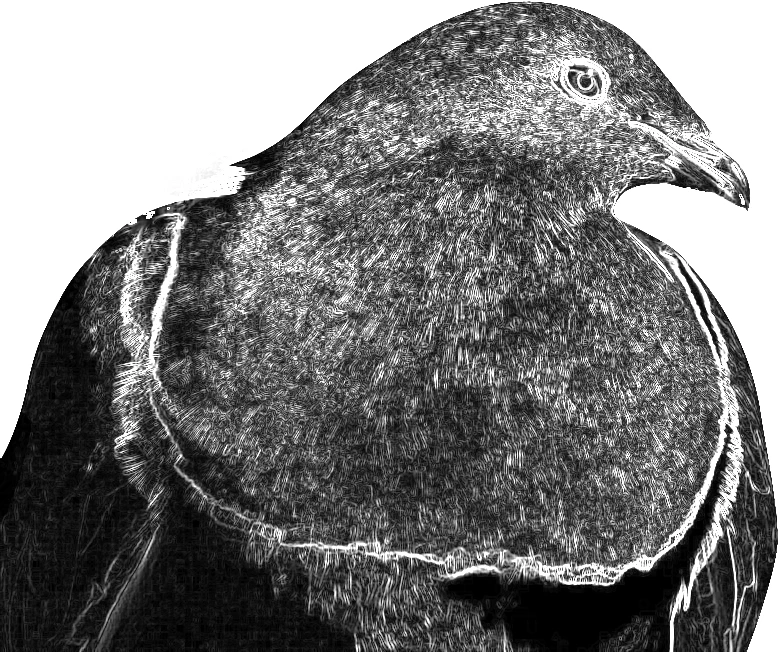

Could I get away with this does anyone know?  I did this with Find Edges and inverted, and adjusted the contrast.
The problem is I am working twice removed from the stamp maker here.  Someone I know was asked to make the stamp and gave the job to another person who gave it to me.    I guess I need to insist on direct contact with the stamp maker and ask how much detail they can reproduce.

    I haven't much experience of preparing artwork for rubber stamps, but I have for producing artwork for foil blocking on binding materials  (both fundamentally are crude letterpress (relief) printing processes. Your rubber stamp supplier should be able to give you advise, but I feel that you need to simplify this artwork as it would tend to fill in. Maybe some kind of keyline outline could work well.

    That was exactly what I was thinking Derek.  I have been promised contact information with the stamp maker since starting this thread, so I'll see what they have to say.  It is always best to speak to the people who will be doing the job IMO.
