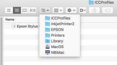

Basically, the printer profiles are in a folder hidden away in the system “library”
Navigate to
Your hard disk name”/library/ printers/EPSON/InkjetPrinter2/ICCProfiles/ [hidden inside a “package”]
[Not in the “your username”/library/ ]
Screenshot below

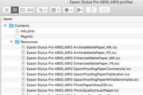

Inside the ICCProfiles folder (see above) is another folder containing the printer name, e.g:  Epson Stylus Pro 4900_4910.profiles
If you right click [or ‘control’ click] it and select "show package contents"
A contents folder appears
Now look inside that folder and you’ll find the ”resources" folder.
see screenshot below
These are the icc profiles which used within the Epson driver [e.g. when you select Photoshop’s printer colourmanagement],
DO NOT DELETE OR MOVE THEM. It’s OK to copy of course.
