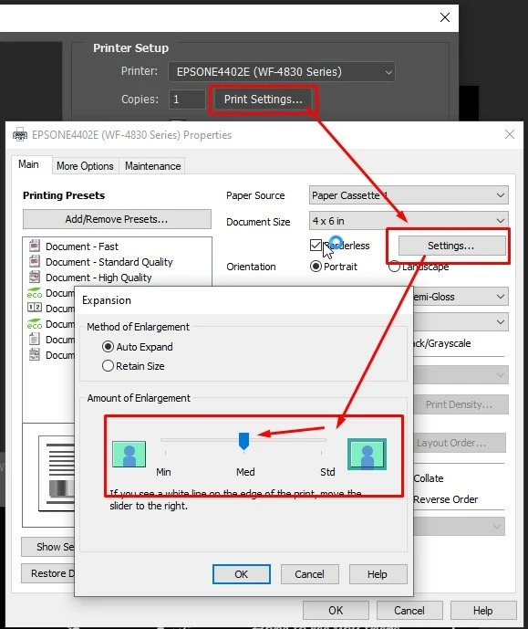

    For my Epson WF-4830 printer I followed these dialogue screens to adjust the automattic enlargement of borderless prints. Without doing so I would always end up with a massive amount of cutoff.

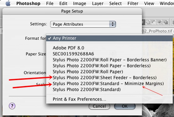

    If it's cropping the image and "cutting off" only one side but the image fills the entire page (without leaving a white band on the long side), it sounds like your image does not have the exact 22 x 17 aspect ratio for an 11" x 8.5" print.
    If you are indeed getting a 1/16" white band, then it's a printer driver issue and the "borderless" option is failing to disregard the "gripping" zone of the printer.  If this is the case, see if the printer driver software has an option that you have not installed for "minimize paper margins" as it's called in some Epson printers. Such options must be installed separately on the Mac, I don't know about Windows.

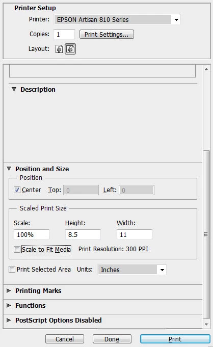

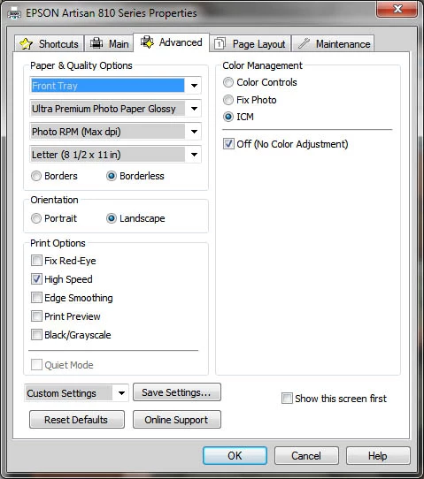

    I have enclosed copies of the Photoshop Print  setup
    and the printer’s own options.
    Any ideas most appreciated.

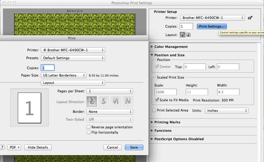

    Does checking "Scale to Fit Media" in Photoshop's Print dialog help?
    Another thought is to change the Image and Printer to Portrait.
    gener7
    August 7, 2013
    Using a Mac, here's screenshot of my settings. See if they work for you.
    August 7, 2013
    Thank you for your quick reply.
    I have similar settings, with obvious differences because of different printers  - I tried both Epson Artisan 810 and Canon MP830.
    Still the problem persists.
