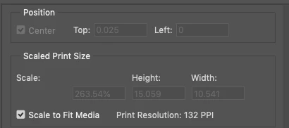

Any idea why my print is slightly cropped?? I used Epson P800 and Canon Pro-1000 with two different Mac Pro and yet Im having the same issue. The size is 4x6 and it should be a problem and yet here it is. Why??

    The paper and canvas are 4x6. Same ratio

    You don't have "scale to fit media" checked on in the Print dialog? It could be running the print to the edge.
    Especially if you have "borderless" set up with the type of paper you use.
