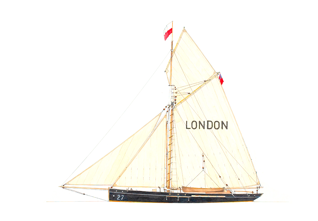

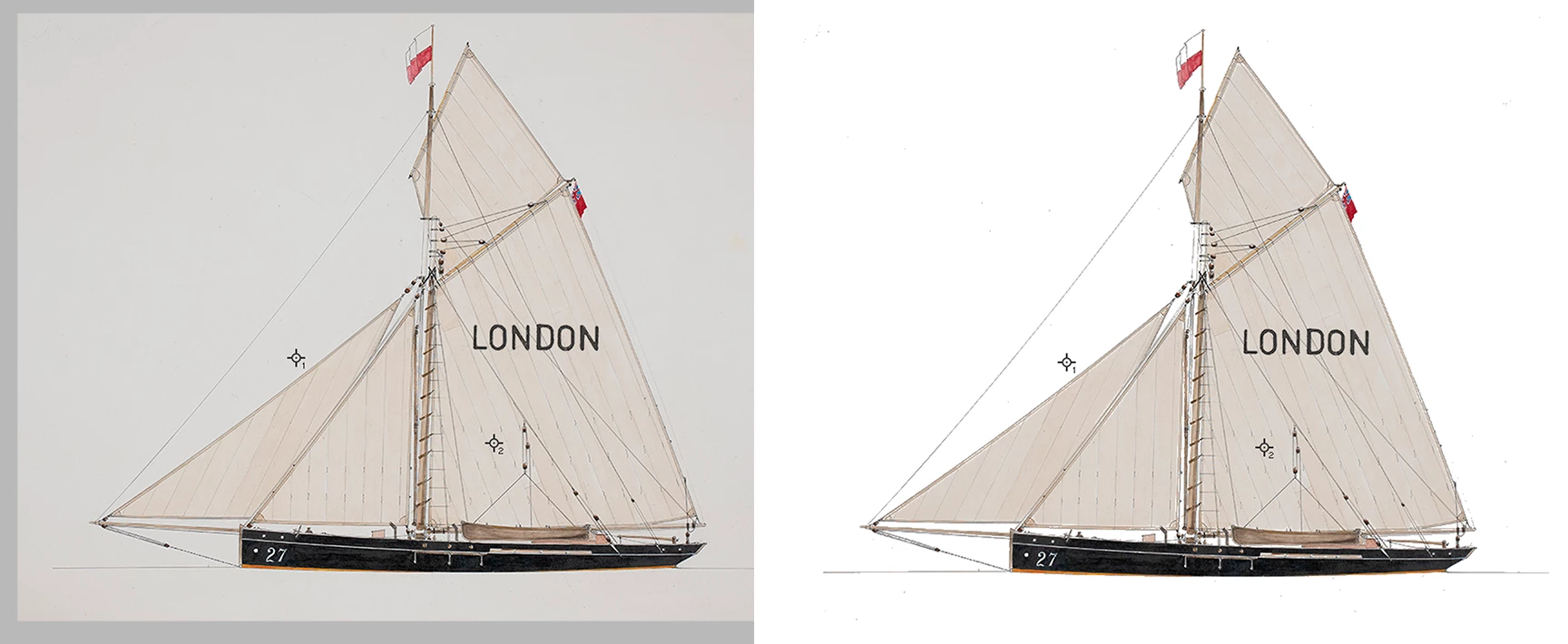

    One last consideration regarding my last post. Watercolor.  If you were to assume the original drawing employed (transparent) watercolor on colored paper or the discoloration affected the sail colors, by switching to Lab Color and eliminating the paper value from the sails, this would be the result. I thought that would interest you.

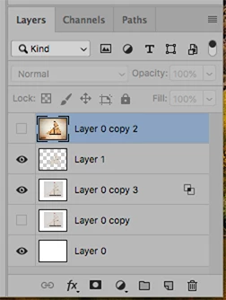

    Norman Sanders
    July 27, 2019
    f
    Hard as it may be to believe, the sails are the same color in both versions. (Click on image for larger view) As shown, two values were marked on an additional image layer and then Curves was used to create a large difference in tones. It looked like this:
    That made the making a selection of the sails easier. The selection was applied to the unaltered image layer and the sails were placed as a layer above the boat layer as Layer 1.
    Then the method I described earlier (Post 10) was used without risking the sail value.
    (Layer 0 copy was used only for reference when the job was done.)

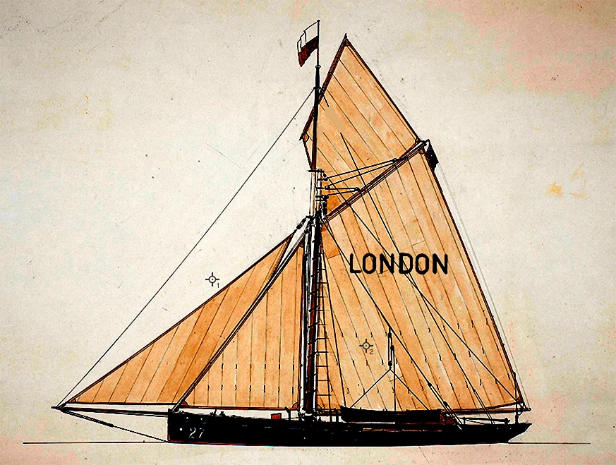

    This is one of the images. I've reduced the size to get it tip here.

    It would be better if you had not reduces the size of the image. It would have been if you posted a small  100% image crop of the image would give us an example of the actual pixel image quality you have.   Resampling an image creates a new image its not the image you will be working on.  Its a completely a different image every pixel in the image was interpolate from the images you have and a lot of details have been lost during this downsizing.    It looks like you have a high quality image  using some of Photoshop adjustment tool will restore much of the image apeaencs and it should be easy to clean up its white background. Its easy to kill white.

    That is an amazing transformation. Just what I am trying to achieve.
    Is this just done by Adjustment , replace colour? When you print this, does the printer now recognise that the white area does  not need any colour. Thanks for you advice!

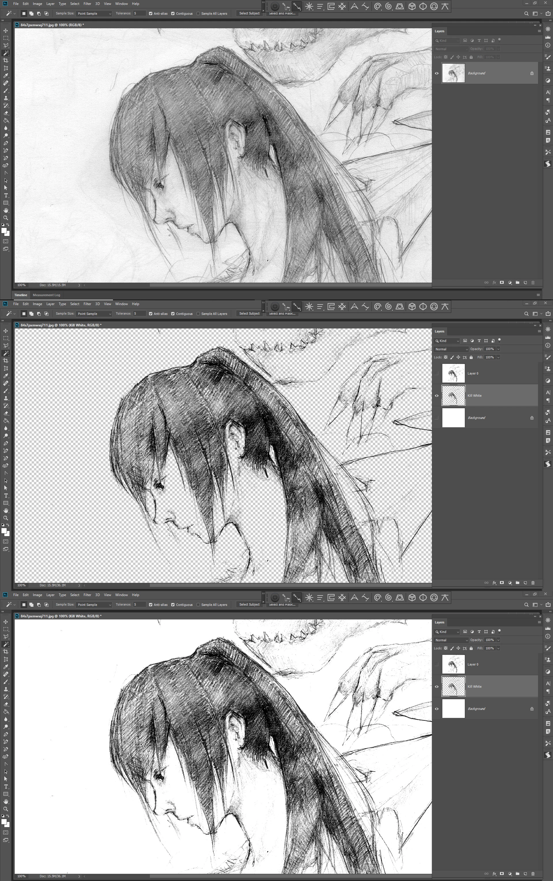

    Please post the image. Short of that...
    Much depends upon the difference in tone valued between the paper and the lightest meaningful tone in the map.
    If it is slight, consider Blend If command.
    Open the image;
    If there is a lock on the background layer holding the image, trash the lock by clicking on it or dragging it to the Trash
    Place a transparent layer below the image layer and Edit > Fill it with white

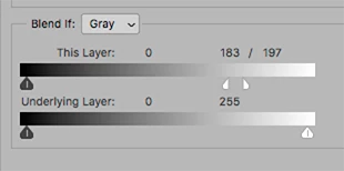

    Double click on the image layer to bring up Layer Style
    In the Blend If section, gently move the top right slider to the left until the paper color disappears.
    If the difference in tone between the paper and the lightest meaningful tone of the map is very slight, you may split the slider for greater accuracy. . Hold down the Option key and click and drag the left side of the slider to the left. Consider it a slow fine tuning of the adjustment.
    Save as psd file and then choose Layers > Merge Down and save as jpg of desired.
