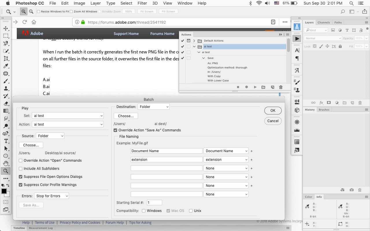

I have several hundred small AI files that I need to convert to PNG files.  I know this can be done in the AI batch converter, but I am having a different problem using that route.  What I want to should be possible in PS, so I am trying this route, too.
I have used the PS batch converter many times, but I still think its sorcery.  Sometimes I get it to work, and sometimes not.
What I typically do is have the original artwork (AI files in this case) in one folder, and I save the PNG files into a separate file.  Doing this manually is no problem, but I have 400+ files this round and I would like to batch process them.  I created a batch action of the following steps:
Open File (opening AI file in PS)
Convert file from CMYK to RBG
Save As PNG
Close file
I set the batch to Source "Override Action Open Commands" and Destination "Override Action Save As commands" (this set of toggles usually works for me).
When I run the batch it correctly generates the first new PNG file in the correct destination folder.  However when it works on all further files in the source folder, it overwrites the first file in the destination folder.  For example, if I have 4 source files:
A.ai
B.ai
C.ai
D.ai
I end up with a single file in the destination folder "A.png", but the artwork is from "D.ai".   I have tried tinkering with different settings in the batch processor with no luck.  At this point I am baffled.  This is probably something stupid simple but I am not seeing it.

    Looks like you don't need the Open or Close steps in the action.
    September 30, 2018
    If I understand you correctly, this means I generate an action with only the conversion steps ?
    I tried the action and it still errors out.  "The Command Convert Mode is not currently available".
    thanks,
    Tom
    Bojan Živković11378569
    September 30, 2018
    That message is displayed when conversion is not possible. You have recorded step to convert to RGB, right? Can you check and expand step in action and post screenshot? Also can you check what is set in Image > Mode after opening file for which conversion is not possible.
