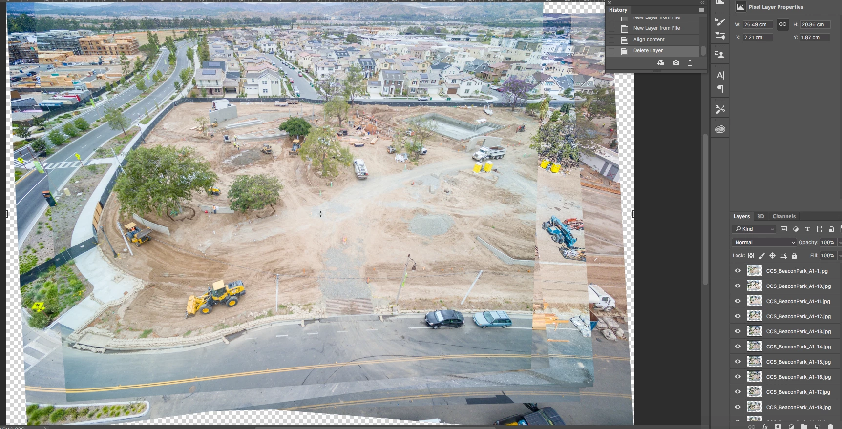

HOWEVER: At this time I have another question related to this. So at this time, I was able to align the pictures almost perfectly in photoshop, and I can see all the layers above each other in the canvas [image]. (Sorry if I don't use the right terminology. I am not a PS pro.)
What do i have to do at this stage to get these images in this relative position to each other exported so that I can put them into a video timeline for a slideshow? Because I must be doing something wrong. At this time when I try to export the images and throw them into a timeline or even when I click through them, they are not lined up anymore. There must be a way to export them exactly the right way!?
Thank you everyone!

Now you need to crop the result to the common overlapping area. Anything not included in all frames is cropped out.
