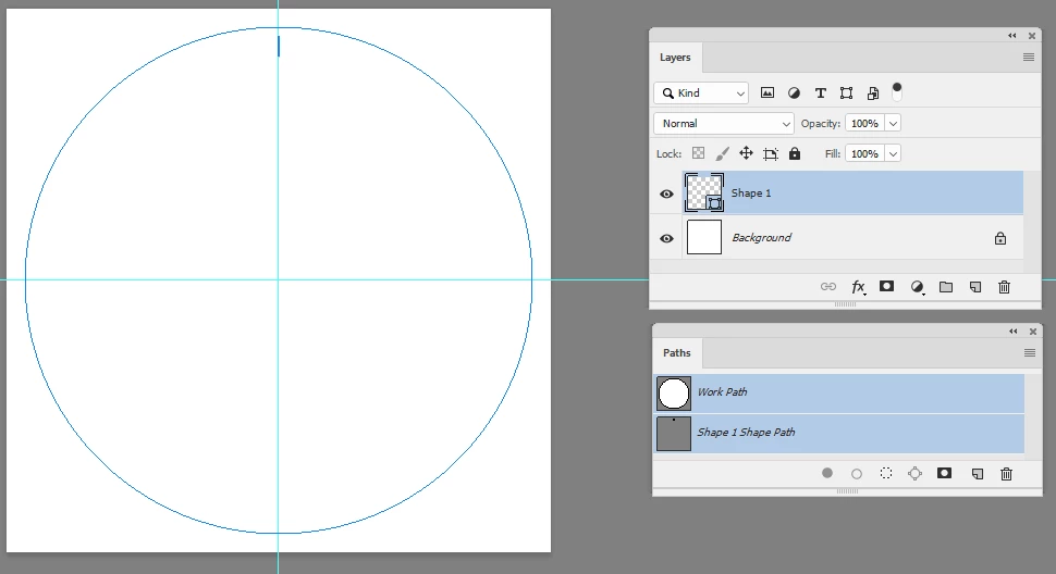

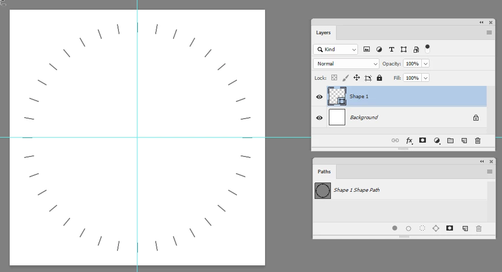

    Make the tick mark shape ( I used the line tool)

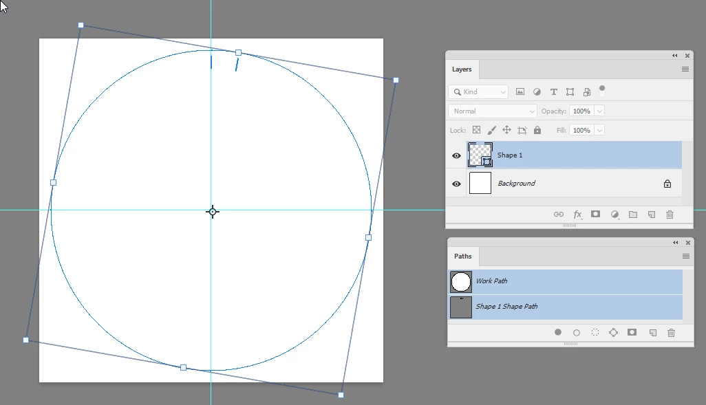

    Make a circular path centred on the document centre
    In the paths panel select the shape path with the line and shift select the circular work path

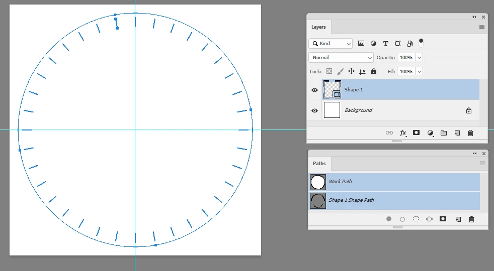

    Ctrl+Alt+T and type in the rotation in the options bar ( I used 10 degrees) - both will transform and be centered on the circle centre
    Press Enter then Shift+Ctrl+Alt+T as many times as you need
    You can now delete the circular path and your shape layer will have the transformed tick marks

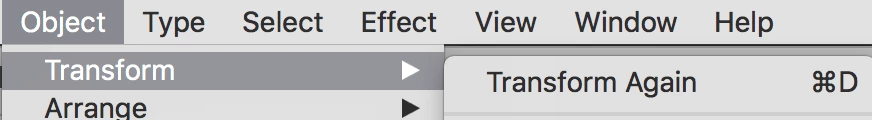

    I agree with Dave that this is easier in Illustrator if you have access to it. Here's how:

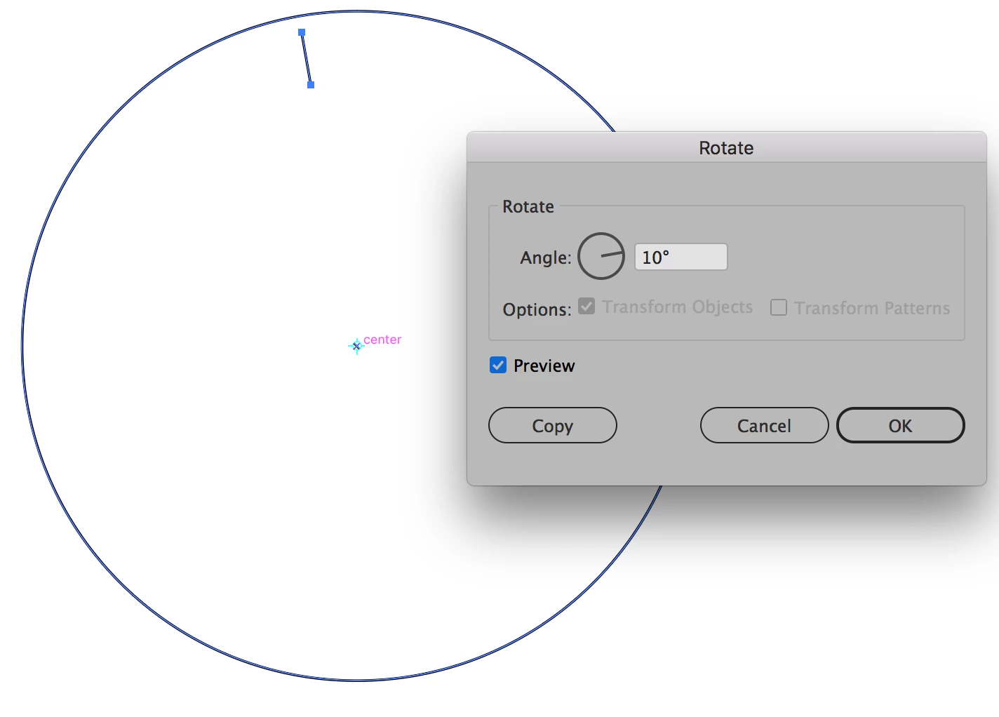

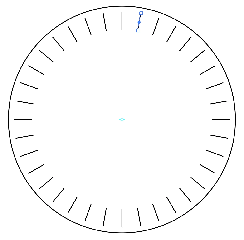

    1. Draw the circle and the tick mark (ellipse and line tools). Keep the line selected and choose the Rotate tool "R".

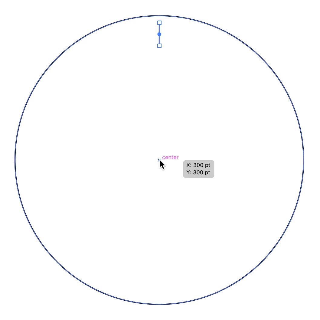

    2. To change the center of rotation from the center of the line to the center of the circle, hold down Option (Alt on Windows) and click in the center of the circle. This dialog comes up. Turn on Preview.
    3. I entered 10 for the angle of rotation like Dave, but -10 would go in his direction.

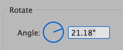

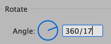

      You can also let Illustrator calculate the angle from the number of tick marks you have. You didn't say what angle you need. Just type 360 divided by how many objects you need and they will be equally spaced.
    4. Then use the keyboard shortcut to Transform Again.
      (Yes, I know what Cmd+D means in PS. And in InDesign it means File > Place!)
    It can also be done as a blend on the circle, then expanded, but this method will give you the precise angles.

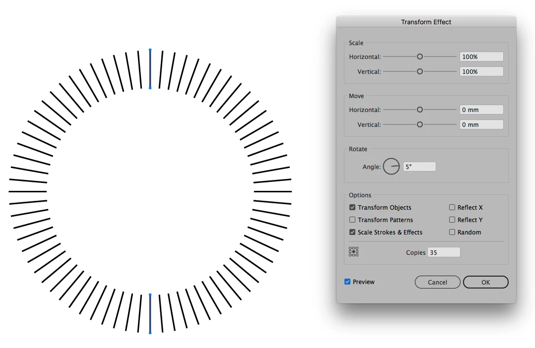

    Even in IIllustrator I would recommend making a group of the two opposing lines.
    Effect > Distort & Transform > Transform can be used to make the copies quickly and editing the original elements will carry over on them.
