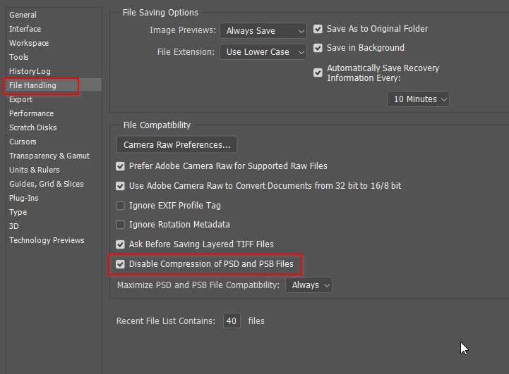

Correct answer Trevor.Dennis
If you are OK with drive space, turn off compression for PSD and PSB files, and the save will speed  up dramatically.

Trevor.Dennis
Trevor.DennisCommunity ExpertCorrect answer
January 12, 2019
