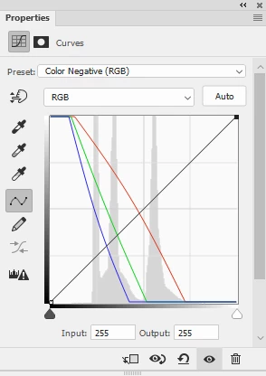

The Color Negative preset in the Curves panel will remove the blue cast in the inverted image, and will in many cases produce good results, but you may need to adjust the individual channels.
Start out by creating a Curves adjustment layer (Layer  > New adjustment layer > Curves), then choose the Color negative preset.
