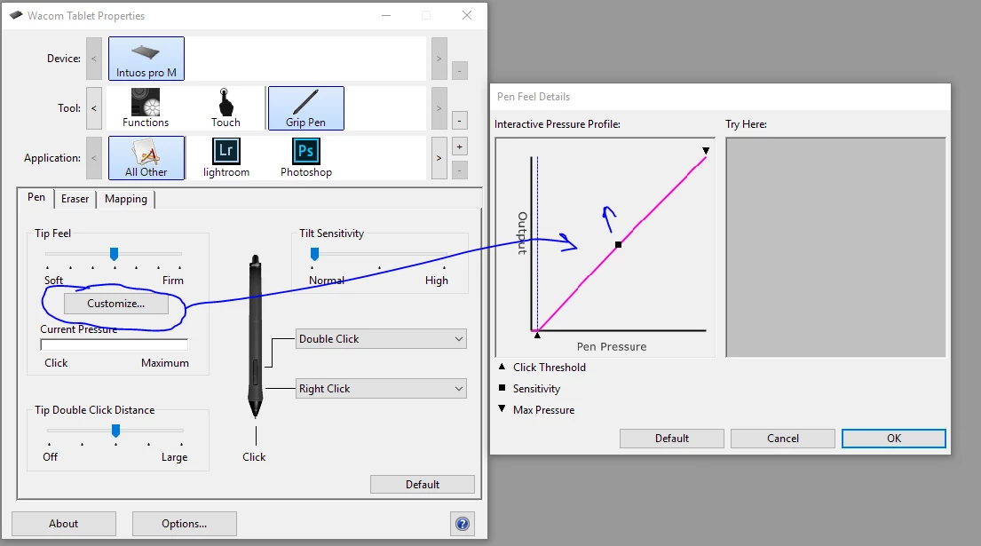

You don't say what pen and tablet you are using.
If it is a Wacom , open the tablet properties and adjust the pressure sensitivity. On the Intuos Pro, for example,  you can adjust the curve so it works for you.

May 19, 2017
How does one get to those settings? Sorry, I'm pretty new to this kind of thing.

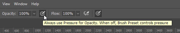

May 18, 2017
Are both buttons enabled in the Options bar.  The left one controls Opacity and the right brush size, and you can have both enabled which would give the effect you have described
May 19, 2017
Both are off, and the effect remains
