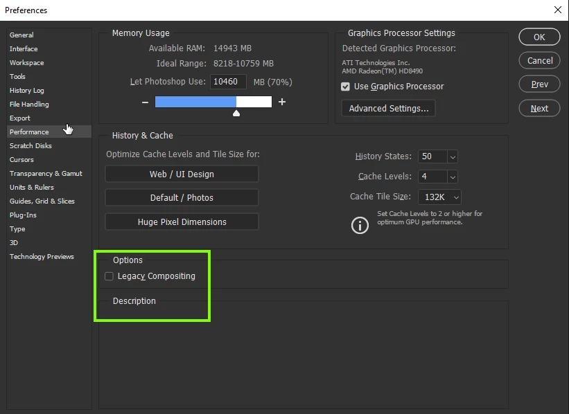

Hi
Try deselecting legacy compositing in preferences and restarting Photoshop to see if it helps
fullyladenswallow
July 10, 2020
Yep, that was it. Thanks very much!
