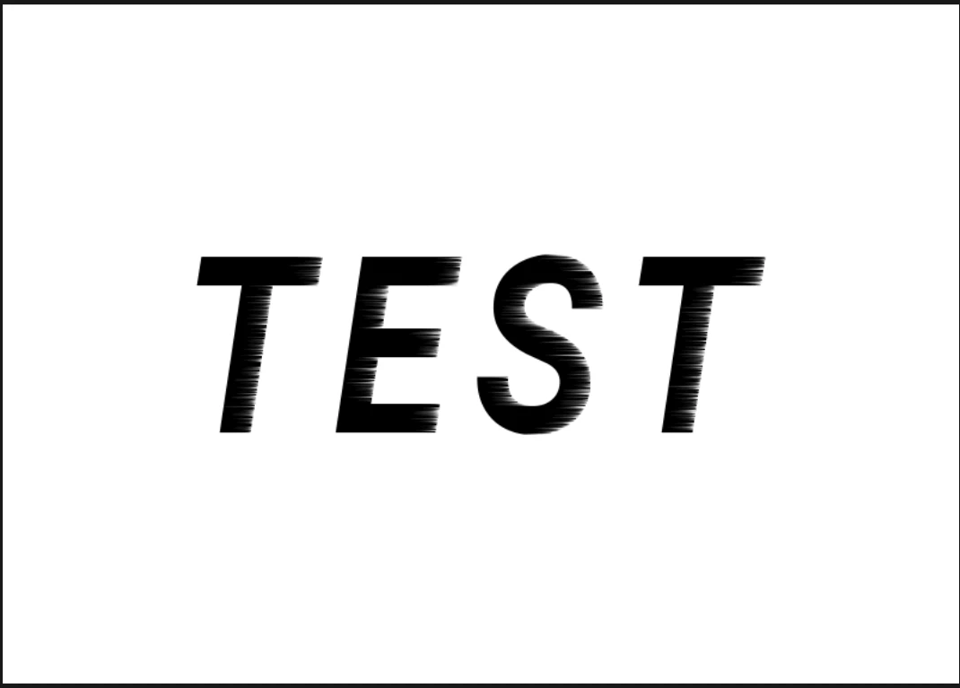

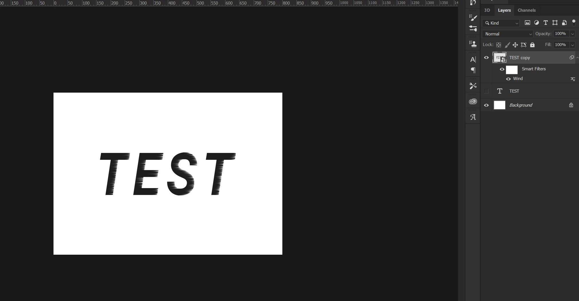

I apply wind filter to a text layer converted to smart object:
Expected Result:
Actual Result:
Whats the problem?

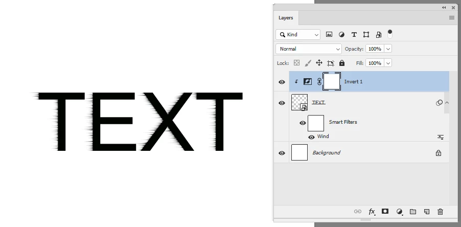

    Hi
    The filter is "smearing" the white so, make the text white then clip an invert adjustment layer to the result
    (To clip Alt- click on the border between the Invert adjustment layer and the Smart Object layer)
    Dave

    Hi
    Dave

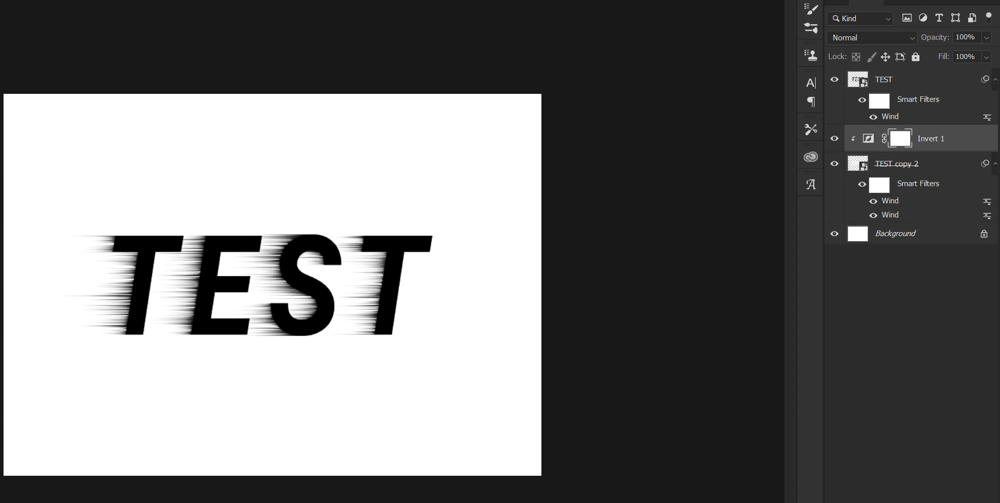

    April 28, 2019
    Thanks that did it, but how do i blend now this result
    with this
    April 28, 2019
    i figure it out, just have to create those as new smart objet, but why does it only works thru white? Thanks
