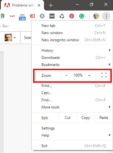

Which browser you are using to preview your site? Did you sent a link to someone to confirm or you got a conclusion from your experience? You are mentioning zoom level, what is zoom level in your browser, can you check that?
