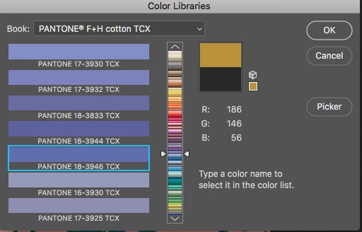

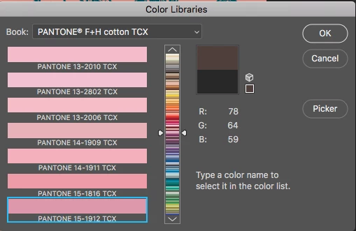

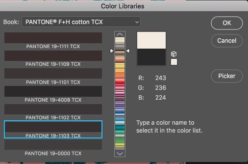

I had been using Pantone Library TCX and TPG no problem last year.  However, recently, when I go into Pantone Libraries, I pick the relevant colour for my work but it changes it to a completely different colour e.g I can pick a blue but it will appear read, or brown, or green.  The reference number doesn't change, it is just the colour that alters. This happens with a huge amount of colours.  I have gone into colour picker to see if it is just a glitch in Pantone libraries and picks the colour I want, but it picks out the incorrect colour given! See screen shot of attached.
I wonder if my settings should be something specific in Photoshop and if so, can you tell me what? I work in RGB and have changed settings and restarted and reimported the books but with no luck.  I am a real novice, so please no technical jargon I can't understand!

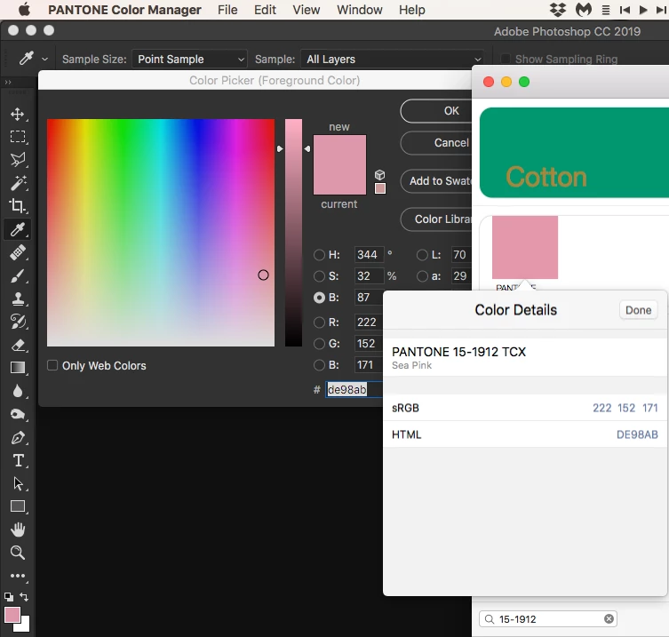

It's true. The Adobe color libraries are way off and this is the workaround I can offer using the PCM. Enter the swatch number in the search box and click on the swatch to get the values.
Simply enter the html code of the Pantone color you want from the PCM. You can create a swatch library in Photoshop for commonly used favorites. The PCM is free if you registered your swatch books with Pantone and it comes in PC or Mac.
