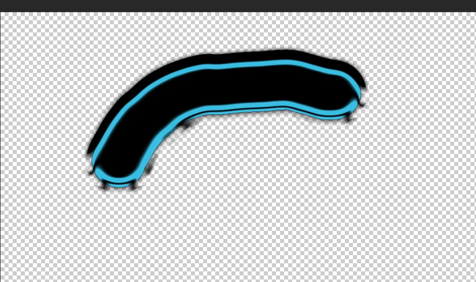

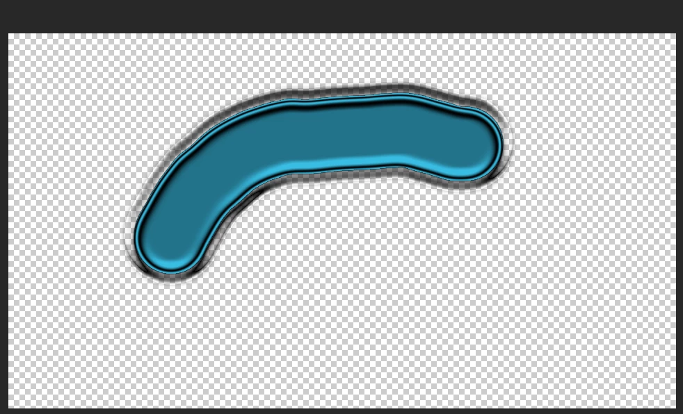

SouthButte
April 19, 2019
Below are examples of the images I created with the embossed metal look.  The first image is correct and the second image was the problem I was having.
These images were create by making paths in Photoshop with a brush.
As I am not very technical with Photoshop, how would I determine the resolution of the metal brush strokes images that I created?

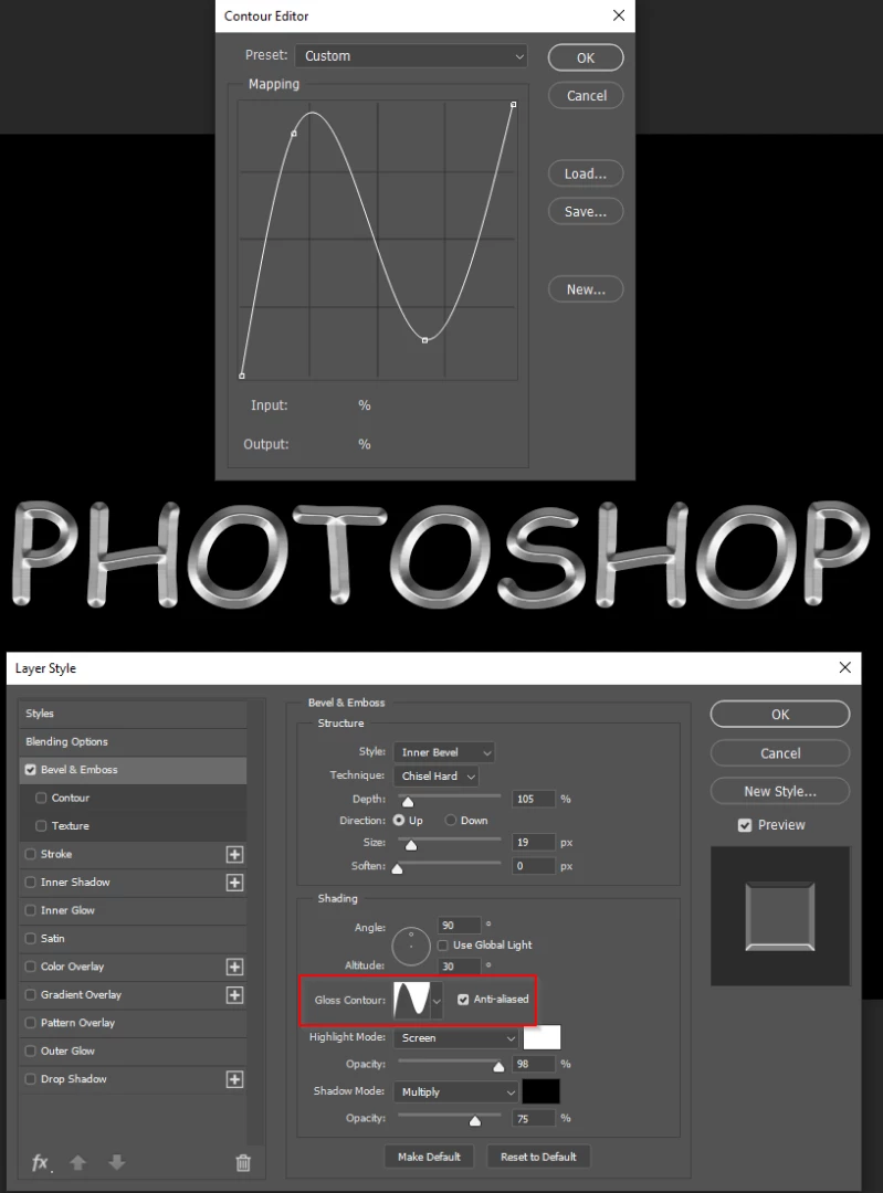

Trevor.Dennis
April 18, 2019
Michael is right in that B&E uses pixels rather than % (which is what Alien Skin Eye Candy uses), so a different image size and brush thickness will make a difference.  Metallic effects tend to use W shaped radical curves, which with B&E means Gloss Contour.  I like to remove all but two of the points from the curve which makes it easier to adjust.  Having Anti Aliasing enabled reduces the jagged edges we sometimes see with B&E.    The Shading  Altitude is also important, but it is manually controlling the Gloss Contour that makes all the difference.
