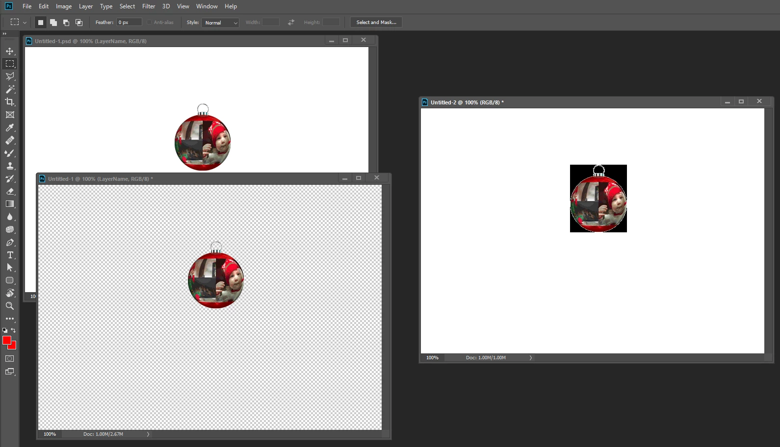

hello all,
I use scripts and actions to speed through my workflow. one of my actions duplicates the current art layer to a new document, names the document "Separation.psd" and renames the layer to "Layer 0", creating a universal document for the commands that follow. My issue is that Ps 2019 seems to treat this functionality differently than it's predecessors, specifically 2019 duplicates the layer as a background layer, which locks the layer, places it on a white background and names the layer "Background".
My problem is that this a color separation work flow in which transparent elements are quite important, and places the art on a white background basically ruins the art
for my purposes.
Has anyone else found this to be problematic?
Is there an explanation for this shift in layer behavior?
Is there a way to program an action or write a script (.jsx) to work around it?
Many thanks in advance.
Correct answer JJMack
There is a bug in CC 2019 that is also in CC 2018.  It is not in CC 2014 or CS6.   I no longer have CC 2015, cc 2015.5 abd CC 2017 installed so I do not know if the bug is in those.
The code copies the background layer to a new document  fine
The code copies a normal layer above a background layer to a new document  fine
The code copies a normal layer above a normal layer to a new document  fine
The code does not copy a normal layer that is at the bottom stack  to a new document  fine in cc 2018 and cc 2019
the transparency about normal layers bounds are blackened  the layers is made a background named Background and the transparency that was outside the normal layer bounds are turned white,

No I see no work around using Action manager code for duplicate layer.  I do not know in which version Adobe broke Photoshop duplicate layer. CC2014 works correctly CC 2018 and CC 2019 do has CC 2015. CC 2015.5 and CC 2017 installed.
I have never used Duplicate layer in a script. I have used Duplicate document  create new documents used Place and copy paste.  From my testing the problem only seem to happen when you copy a bottom layer that is not a background to a new document.

Layer duplicated to a new document from a document with only one layer that is not a background will become a background (flattened) in that new document instead of be simply duplicated as a layer (with transparency, effects etc). That happens in CC 2019, that seems to work still in CC 2018, but for sure in CS6 Extended. You may click links from the other post of me to Photoshop Family to read more. I'm not saying here of duplicating document what works good.

Thats what I'm thinking, and I was toying around with it some more today and found furhter evidence to suggest that it's a bug.
If i have two documents open, and i use the duplicate layer command to copy a layer from Doc 2 to Doc 1 the layer doesnt change. It only seems to happen when duplicating to a new document.

Try this code (it works correctly in CC2019 with normal layer):
sTT = stringIDToTypeID;
(ref = new ActionReference()).putEnumerated(sTT('document'), sTT('ordinal'), sTT('first'));
(dsc = new ActionDescriptor()).putReference(sTT('null'), ref), executeAction(sTT('duplicate'), dsc)
however it duplicates whole document, so doesn't create new document from selected layer

Kukurykus
December 17, 2018
This code works same both in CS6 Extended and CC 2019 for document with a background.
When I changed background to normal layer I see difference, so you are right - that's a bug?
From a document with normal layer I got in CS6 normal layer, while in CC2019 background!

JJMack
JJMackCommunity ExpertCorrect answer
December 17, 2018

I apologize for the confusion I'm obviously not explaining this very well. The layer name seems to only be a symptom of the larger problem. Mainly duplicating any layer to a new document automatically converts that layer to a background layer. Changing it's appearance, in addition to renaming andlocking it. Ps did not have this behavior in prior versions. I'm trying to find a work around for this occurence that works with all versions.
