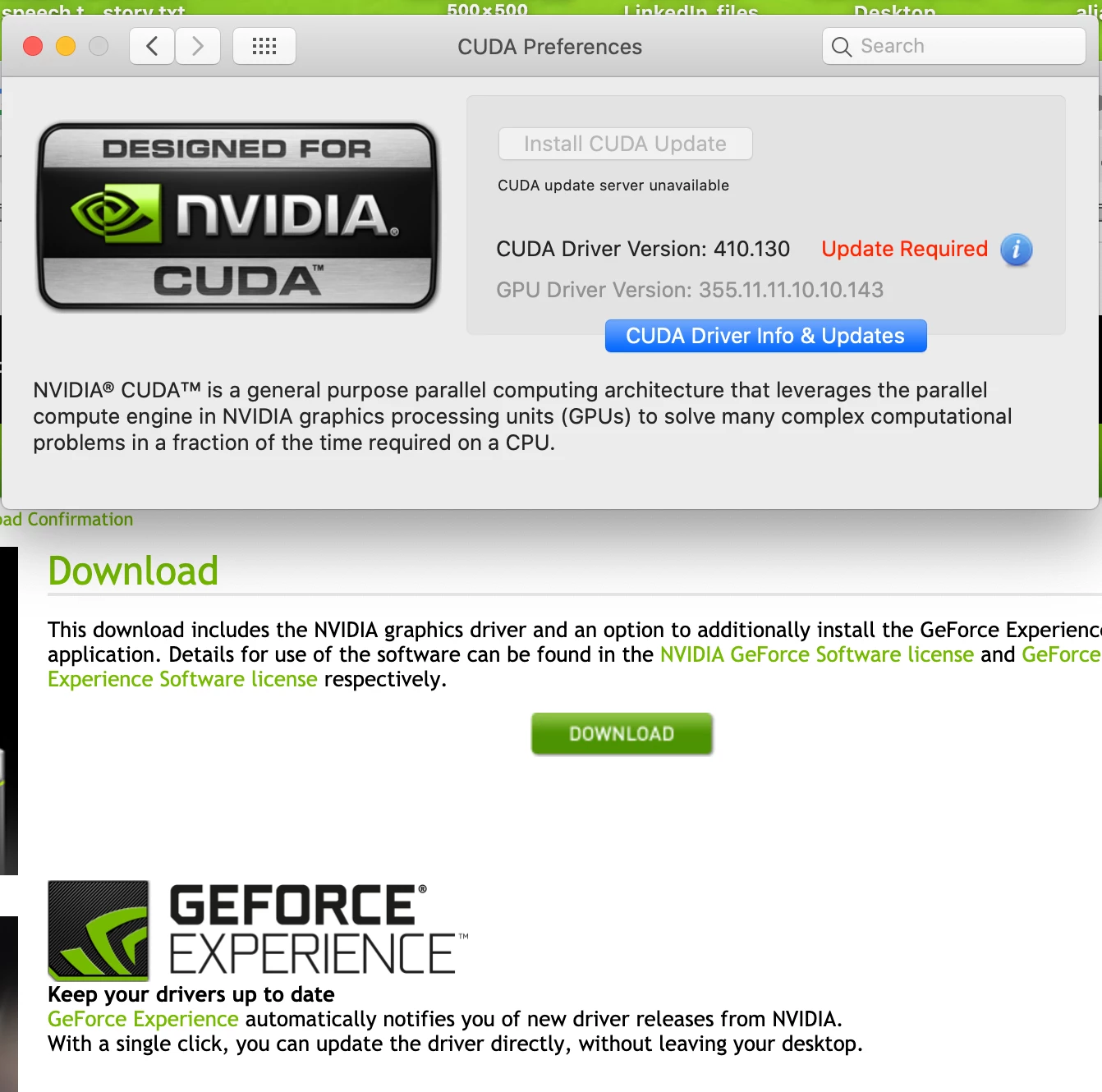

Anyone had this issue (probably a few years ago now)?
You go to Preferences > Performance > Graphics Processor Settings in Photoshop 2021 and the option to use the graphics driver is greyed out, along with filters like Oil Paint, etc, because Apple dropped support for NVIDIA drivers.
Having just updated my 2013 MBP to Catalina and my Photoshop to 2021 I'm disappointed to find Photoshop, and other processes, hampered by this.
Is there a fix?
BTW: CUDA drivers do not work for this issue, despite what some Apple Support staff tell you.

Thanks Kevin et al.
Yes, it does seem that installing CUDA, as instrcted by the first Apple support employee I contacted via Support chat, was wrong.
There is no point trying to install a new graphics driver on a Catalina 2013 MBP.
I have had to manually delete CUDA and it's a relief to know that the graphics driver is integral to the OS as I could easily have caused a greater problem if it were otherwise.
Clearly 2013 MBPs will soon hit total obsolescence so I'd better get saving for the replacement MBP, A modern (£2k!) equivalent machine 😅
