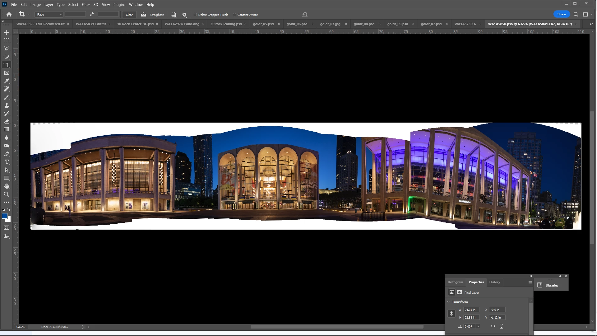

Hello PS combatants,
I tried to create a panorama in PS 2023 on a Windows 10 PC because LRC could not process it.  Sure enough the panorama was performed in PS but there are too many empty pixels both above and below the image as well as a scalloped border both above and below. Some of the buildings are cut off as well as much of the sky. In LRC I have the option to try an option other than 'Auto' like Spherical or Cylindrical but I cannot find that option in PS. I cannot clone in any areas or do much at all.
Any ideas on how I can salvage the image which is quite nice.

    June 1, 2023
    D Fosse,  Hello.
    Here is a screen shot taken from the 'Spherical' algorithm and after a crop. I don't quite get the suggestion that I break it up into individual components. Do you mean 3 images for each building and then take the three recons and put them into the pano algorithm as well?  I can always try the content aware fill on that result if necessary but usually CAF is a crap shoot.

    June 1, 2023
    I mean doing it in three steps:
    • Stack your individual frames as layers. The important consideration here is that the layer at the bottom of the stack will be the reference that the others align to. You'd normally put the center frame at the bottom. This reference layer will not be transformed at all.
    • Run Edit > Auto-Align. Here you can chose the algorithm, but in my experience Auto usually works well. Nudge individual frames if necessary.
    • Run Edit > Auto-Blend, make sure to pick Pano mode, not Stack (that's for focus stacking). Merge the layers.
    This is what Photomerge does, you just have a lot less control with the automated script.
    Another thing to be aware of. A panorama is basically just another way to create ultra-wide-angle views. The same optical laws apply - meaning that to maintain straight lines, the corners will be stretched. The wider the view, the more extreme this corner stretching gets, to the point where you get the "butterfly effect". Then you've taken it too far, and the only realistic option may be cylindrical or spherical (fisheye). That doesn't look good for buildings where you want straight lines.
    It's important to stress that this is geometry, not Photoshop. There's a limit to what can be realistically represented as one wide angle scene. In short: be realistic. Don't attempt an extremely wide view if you want to maintain straight lines.
