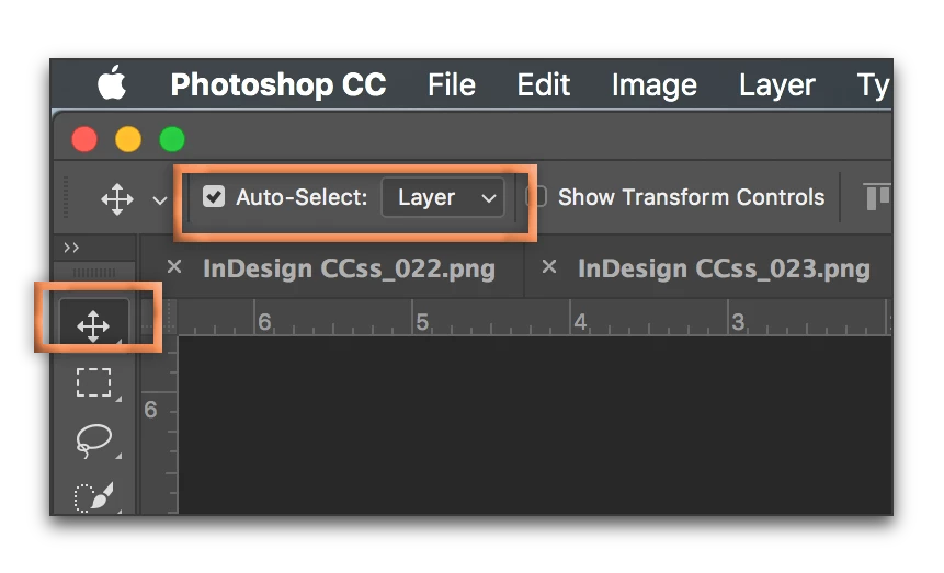

Hello. I recently switched from CS6 to CC, and I am having an issue grabbing and moving objects in PS. Allow me to explain.
I take volunteer to take photos for our local shelter. I have a specific watermark that I use on these photos, made up of 7-8 different layers. Even with all the layers selected, I can't move the watermark around the image. When I transform it to resize, it only seems grab two of the layers, even though all are selected.

Correct answer Barb Binder
One note: there was a default change between CS6 and CC: when you have the Move tool selected, Photoshop CC defaults to Auto-Select Layer on. It's been there for years but defaulted to off. Try unchecking it and PS will move things like it used to.

Barb BinderCommunity ExpertCorrect answer
July 25, 2017
July 26, 2017
OMG that worked! I feel so stupid now! LOL! Thank you so much BarbBinder!
