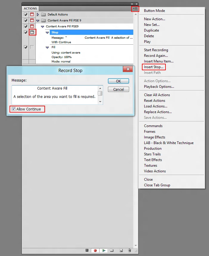

You can use the Insert Stop from the actions panel flyout menu, type your message (anything you care to type), and check Allow Continue.

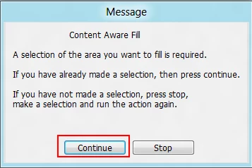

Dialog when running the action, before the action does anything:

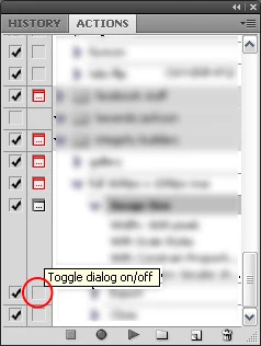

When I previously noticed that option on that fly out menu, I just thought it was the same as clicking that little box just to the right of the arrows (see image below). It was just something I overlooked.I guess I confused pausing the action to inserting a stop.
