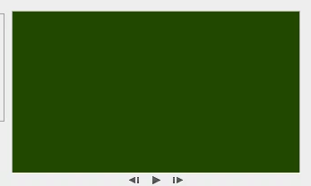

    so here's a screenshot of the green screen i get when importing mp4/youtube videos after i reset my preferences

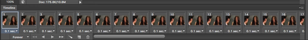

    and for my timeline as you can see theres just a blank space where the conversion button should be

    Benjamin Root
    Benjamin RootCorrect answer
    January 9, 2017
    Be sure your graphics drivers are up to date. If the problem persists, disable GPU acceleration and restart Photoshop. (Edit > Preferences > Performance > (un-check) Use Graphics Processor). If disabling the GPU works, it's a problem with your graphics driver(s) or hardware. Try rolling back to an older driver.
    NVIDIA: http://www.nvidia.com/Download/index.aspx?lang=en-us
    AMD: http://support.amd.com/en-us/download
    Intel: http://www.intel.com/p/en_US/support/graphics
