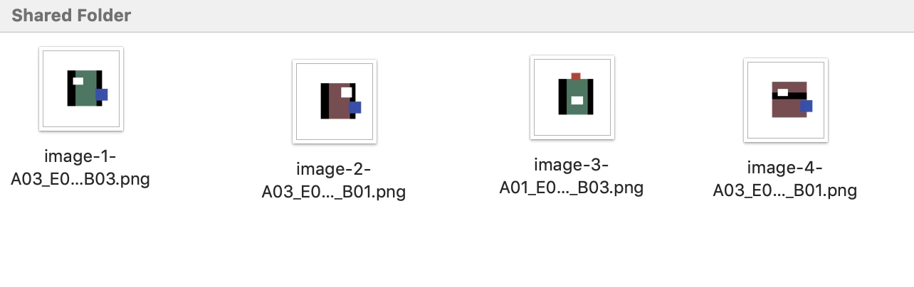

Hi Stephen, Thanks, not sure if it’s what @Crow26362741bzyz wants—my script is writing the number of layer groups x the count—if the requested count is 4, 16 PNGs are written.
If we take the save function out of the loop then 4 files are written. So (EDIT: I simplified the variables functions):
