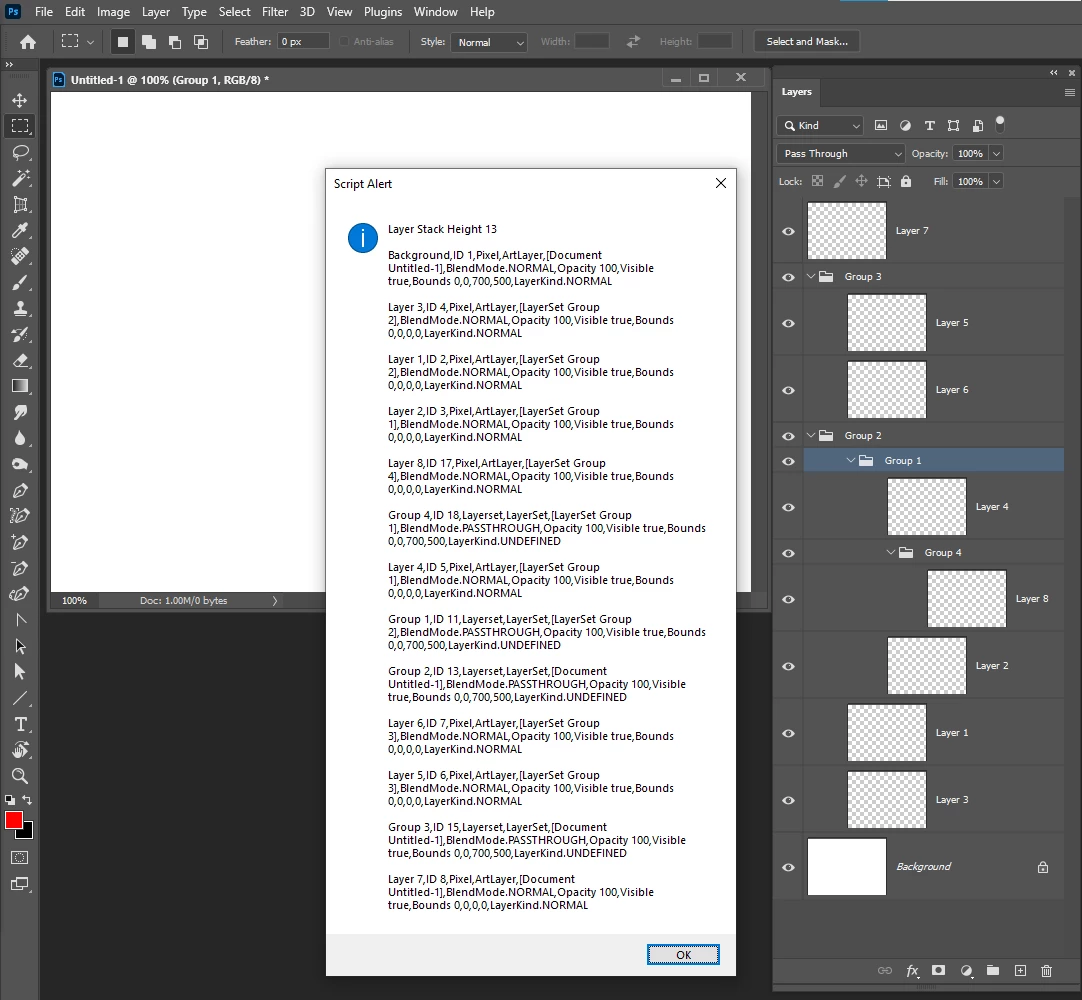

The first in the group?  If you target three layers and create a group from the layer which is the first in the group the bottom layer in the group the top layer  in the group? You can process the layer stack see the stacking order, see layer kind,  id, name, parent, bounds, etc.  Layer groups can be nested. So you can create Lists of  layer in a layer group in the stacking order in the group. However, between layers in a layer group the can nested layer groups. So some layers and some layer groups can have the document be their other layers and layer groups can have other layer groups parents.
