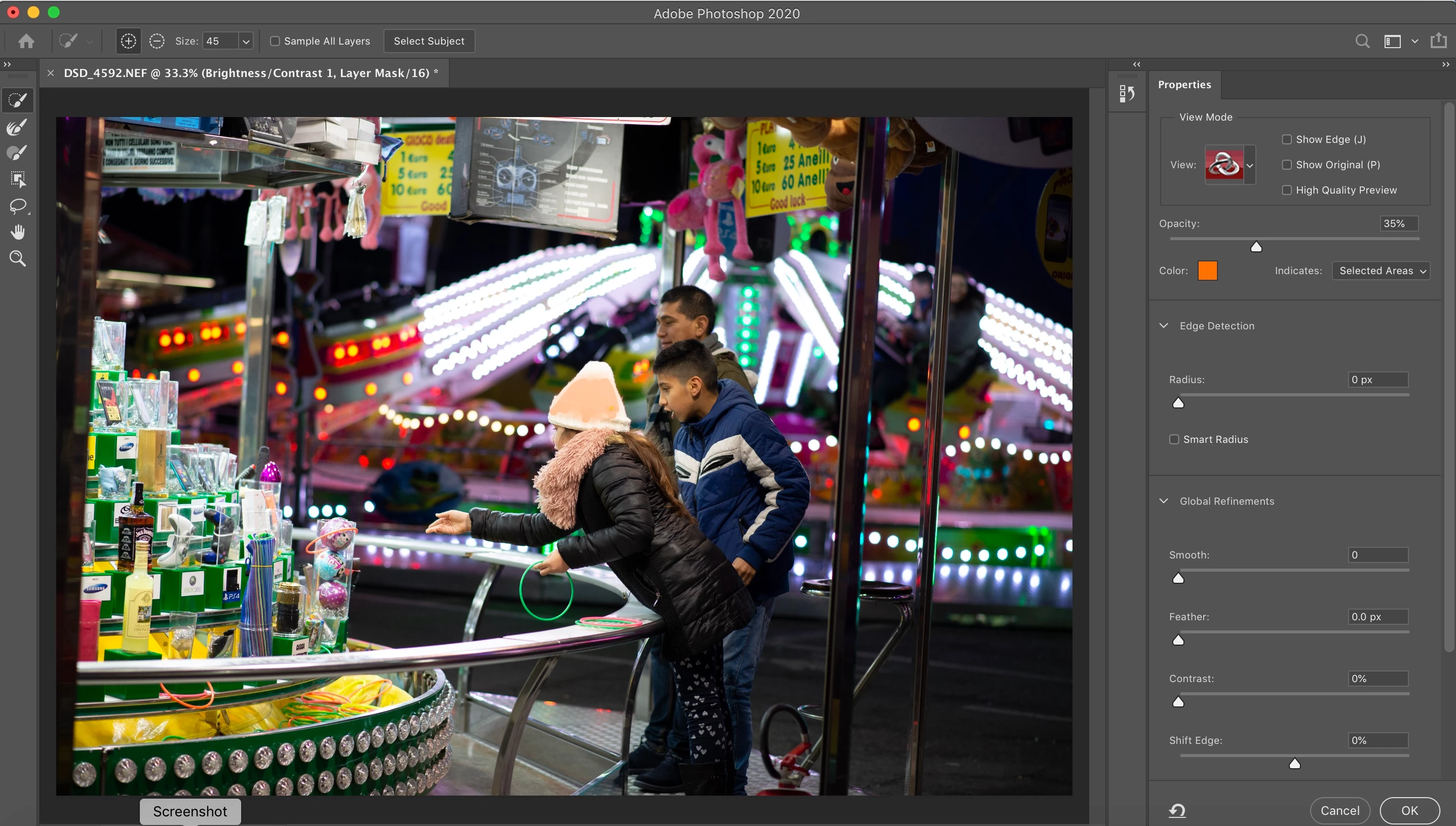

When using quick selection tool from "select and mask" of any adjustment layer PS, IF "sample all layers" IS NOT SELECTED PS blocks. The same does not happen if "sample all layers" is selected and does not happen if use quick selection tool directly on the image. I resetted the tool but nothing changed

mglush
December 30, 2019
Hi! Can you post a screen shot of what you are describing?
Michelle
Paolo1957Author
December 30, 2019
Hi Michelle, thank for your attention.
I attach the screenshot you asked for: I started selecting the white hat and the process stopped. By the way,as you know, the normal mode of operation (with older versions of PS OR checking "sample all layers") is that after few brush strike a selections is done: this did not happened here, what you see in orange is the area I brushed. It seems that if you do not tell explicitly to look also to other layers PS attempts to make a selection only from the current layer which is an adjustment layer where no image is present.
