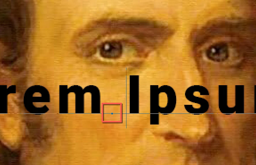

Before you reset anything, see if this is the issue. When you click and then type, you will see a little "point" when you have an insertion point. When you choose aligment of left, center, or right, the text aligns to that point where you clicked, and you may get the results you are descibing. To "fix" it, do one of the following:
  • Pay attention to where you click
  • Move the text with the Move tool
  • Drag a frame with the Type tool, then type. Alignment will be across the frame, which can be resized.

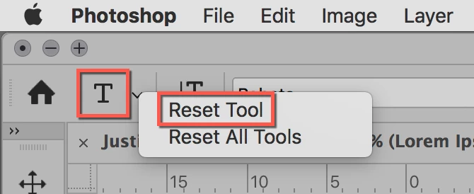

If this fails, reset your Type tool from the options bar
or reset Preferences from Preferences > General > Reset Preferences on Quit.

Hello, in the paragraph panel, click on the top right menu, and select reset paragraph.
Do it also for the Character panel, and maybe on a right-click on the type tool icon in the option bar.
If you do not want to reset your preferences, shut down photoshop, drag the entire preferences folder to the desktop, restart Ps, you can revert by replacing your old preferences.
