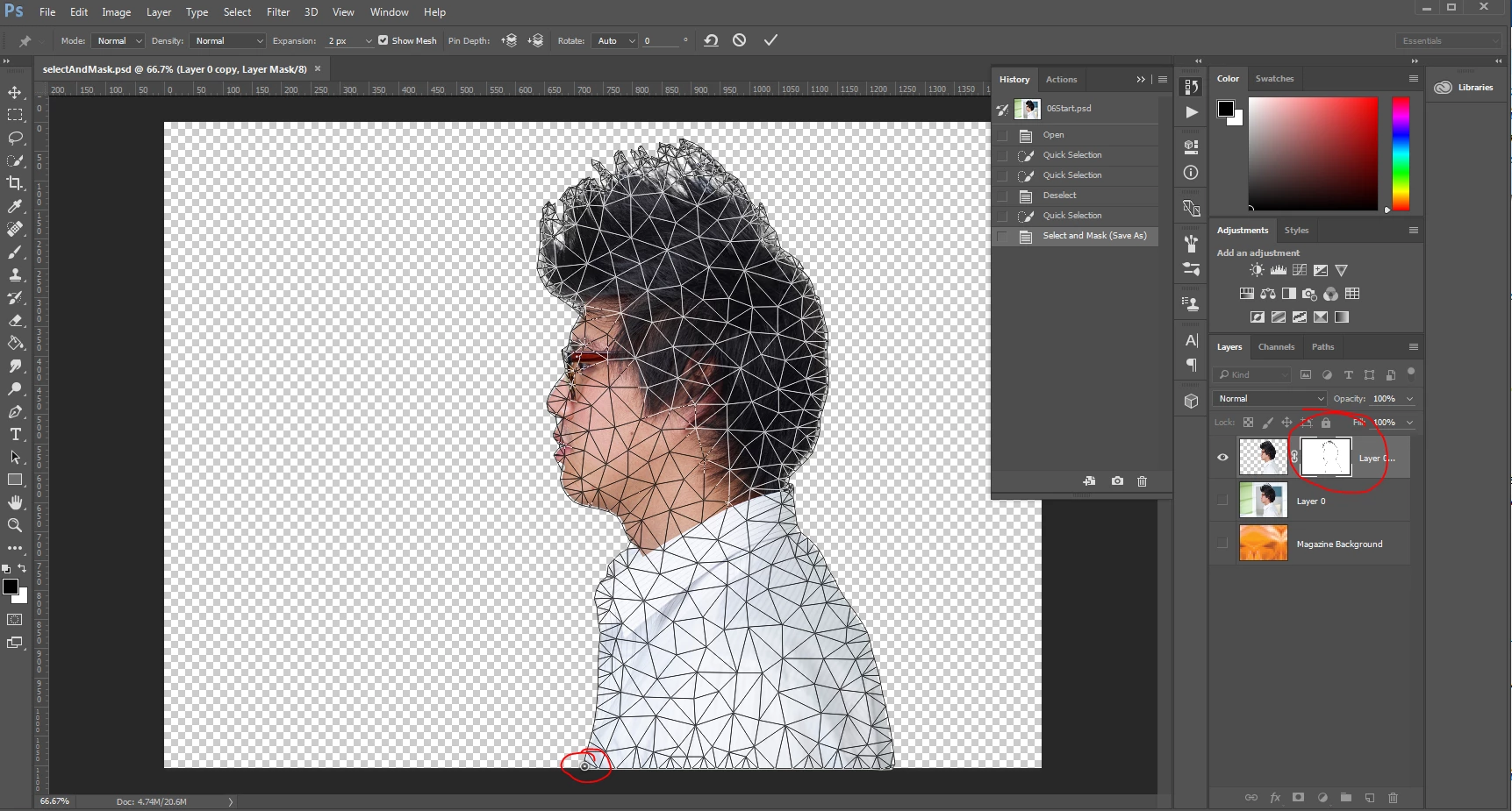

My students are running into a problem and I am too. This is the first time I've experienced this issue and I've no clue what is going wrong.

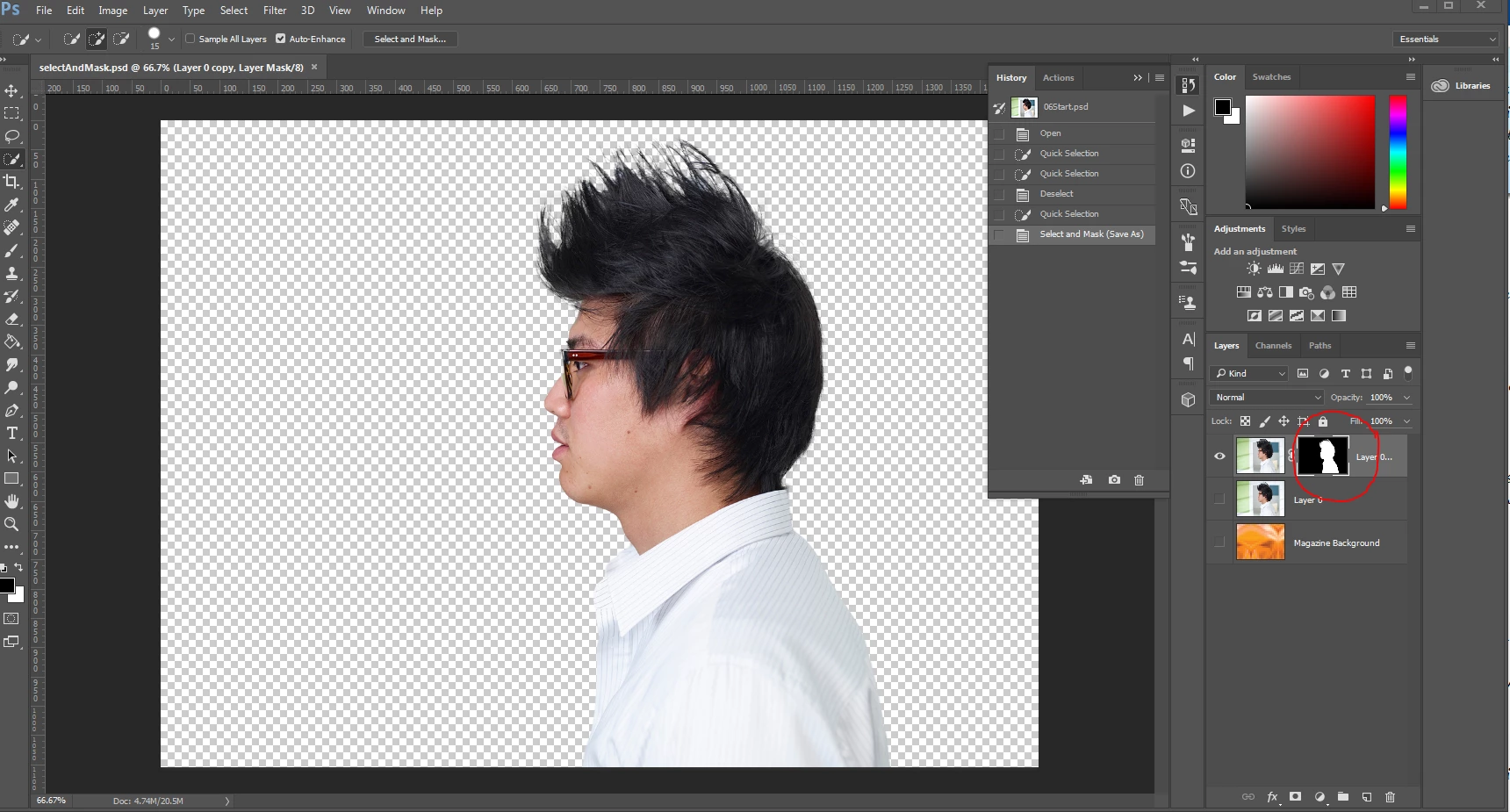

For one of the chapter projects, you select, refine and create the layer mask of a model. I rewrote instructions to use the new Select & Mask tool which works wonderfully. However, when we get to the step to apply puppet warp, the minute a single pin is added, the layer mask is altered and all that is left is an outline of my original selection.  Screenshots attached for before and after puppet warp. Anyone have any solutions?

It looks like you have the mask itself selected (and not the layer) when you apply the Puppet Warp? (See the corner outlines in your screen capture.) What happens if you select the layer itself before invoking the Puppet Warp?

I have what may be a silly question, but it's worth asking. Are you ensuring that the link between the image and mask are turned on, on the layer?  I'm referring to the chain between the mask and image icons.
Ive made that error on occasion, so its worth checking.

Thanks everyone for your helpful suggestions! I did find a workaround last night. Instead of outputting to a new layer with layer mask I chose layer mask only. I duplicated the layer w/mask and then used puppet warp on the duplicate layer. It worked but I think it was just luck.

February 10, 2017
Well, I have to say I haven't had the best of luck. I did reset all tools and reset the preferences, and I still had the same issue with the puppet warp altering the layer mask. I did take Trevor.Dennis's approach and made the layer a smart object. Once that layer is a smart object the puppet warp worked fine on the smart object layer. Still same issues if trying it on the psb (I was trying everything). However, I was hoping to keep some of the original textbook tutorial which had the puppet warp applied to the model and it's layer mask. With it as a smart object, the mask doesn't get warped which is used for a shadow layer.

So the only solutions I've found is to go back into the mask and repaint the black sections after doing the warp. it's not pretty but it's a quick fix. Still looking for alternative solutions.

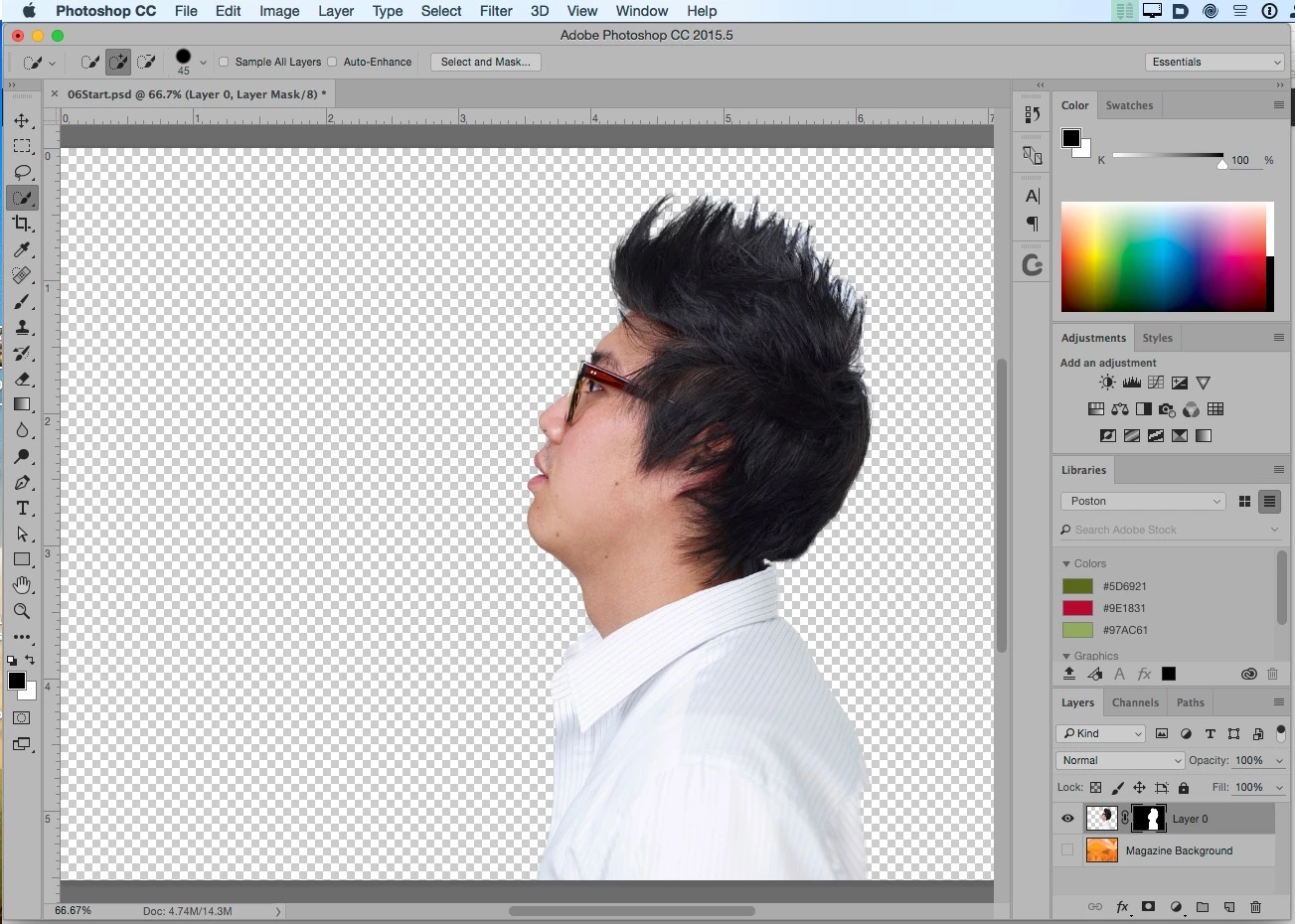

Interesting... mine lets me keep the mask during and after the application of the warp, even without turning it into a smart object (see below image after puppet warp was applied).
I like the idea of Smart Object to resolve lynn_k's issue, but on my Mac, it's not necessary as you suggest, Zaid...

I can say that it still works perfectly on my Mac (same Photoshop version, same lesson file), so it may be a problem with Windows. Have you recently updated/upgraded your Windows installation?
