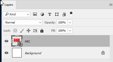

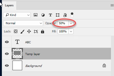

You could do this as a workaround:
1. Add a temporary layer below the text
2. Select and fill the area on that temporary layer encompassing the text with a solid colour - I used 50% grey and turn opacity down to 40% so you can still see through it
3. Convert the text layer and temp layer to a single smart object

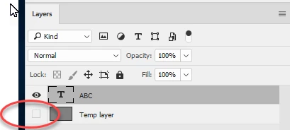

4. Apply your puppet warp to the smart object
5. Open the smart object and switch off visibility of the temp layer.
6. Close and save the smart object
I hope that helps.

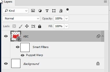

davescm
August 19, 2017
At the moment - puppet warp only gives a mesh where there are pixels, so you have to give some pixels to work with.
However , once you have used the method above, if you need to re-edit the mesh you don't need to turn back on the temp layer. Just double-click on puppet warp under the smart object in the layers panel and the entire mesh re-appears.
Dave
