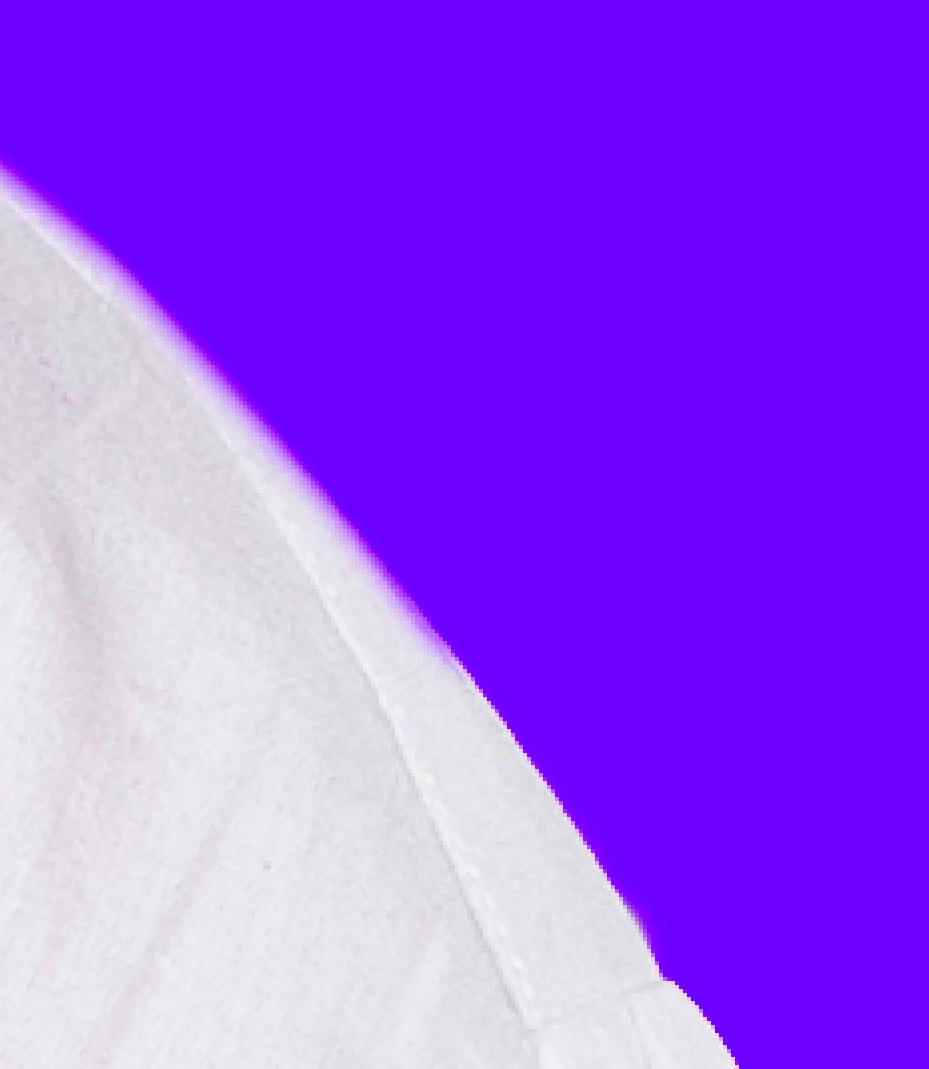

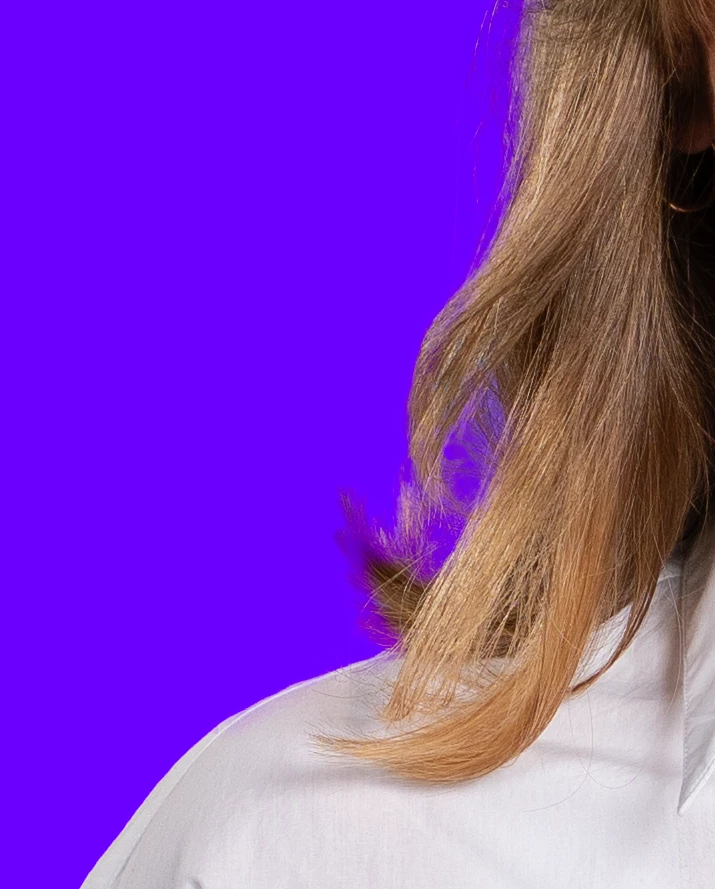

When putting a cut-out portrait on top of  a filled layer with the purple colour #6F03FF
the portrait edges get pink/magenta color. I never experienced this with other colours. Normally they blend in nicely with a lighter or darker grade of the same  colour- But  with #6F03FF the result is really totally different,  making pink/magenta edges when mixed with the purple colour.
If anybody has experienced the same problem I would be happy to hear about a possible solution. When masking an object, with a soft brush or masking hair, this is really distubing when the edges gets a really different colour when mixed with the purple background colour.
See attached examples.

You could try tightening up the contrast on the mask. ie not have such a gradual transition between black and white.

Yes, thank you for your reply!  That helps a lot in some situations when a hard edge is ok. But when it comes to hair and some clothes/fabric it dosent look realistic with a to hard edge. And the crazy thing here is: if i use a grey, green og maybe blue background color I do not face this problem with the backround totally changing into another color when blending into the soft edge of the layer above the background. I have done this with composites for many years without this strange colour shift happening. This is the first time I experienced this issue, because the client want a purple background.

While it doesn't happen regularly, I have seen this issue over the years where certain combinations appear to blow out specific colours and/or the saturation.
You could try adding a Hue/Saturation adjustment layer and clipping it (Layer > Create Clipping Mask) to the portrait layer below it. Reduce the saturation within the Hue/Saturation layer and use the mask to paint away the saturation in the problem areas. A very manual method but it should do what you need.
