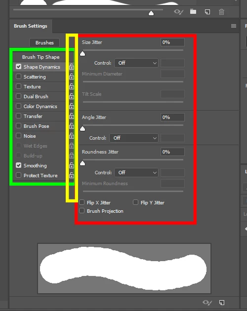

Hi all,
I'm trying to access (get/set) for Brush Settings' Lock features as following yellow rectangle part.
Are these accessible (get/set) from script?
The reason I'd like to access is protecting value changes on Opacity, Flow, Smoothing, Strength, Exposure on brush value by script.
Current code is get and reset following green part. But red part gets reset and I'll need work on.
It seems when yellow part are "protected", it seems no get reset by above (opacity, flow, ...) changes.
#original purpose was just changing opacity, etc, but got reset issue and trying to avoid.
There seems not recorded by ScriptListner and regular Actions.

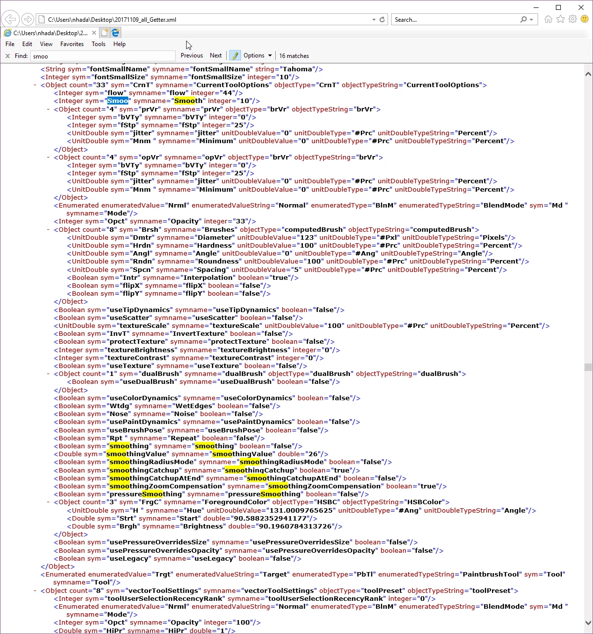

I also searched around exported getter.xml from Xtools' GetterDemo.jsx file.
xtools
But I could not find related properties.

Actually, I have CS6 and I can only change the parameters of the Brush object, and I can not change the opacity and other parameters due to an error in Photoshop.
With the locks, the question is open. If there is a lock, then the parameter through the script can not be changed. I found several identifiers that the photoshop understands:
stringIDToTypeID("smoothingLock")
stringIDToTypeID("brushTipDynamicsLock")
stringIDToTypeID("scatterDynamicsLock")
stringIDToTypeID("textureInteractionLock")
stringIDToTypeID("dualBrushLock")
stringIDToTypeID("colorDynamicsLock")
stringIDToTypeID("brushPoseLock")
stringIDToTypeID("noiseLock")
stringIDToTypeID("wetEdgesLock")
stringIDToTypeID("paintDynamicsLock")
stringIDToTypeID("repeatLock")
stringIDToTypeID("strokeStyleScaleLock")
stringIDToTypeID("protectTextureLock")
But I do not know where and how they can be applied so far.

What do I think about locks. You can use the "reset_tool ()" function after you receive the "currentToolOptions" descriptor. It will reset all locks. After that you can change only the necessary required parameters and call the "set" command as usual.
function reset_tool()
    try {
        var desc = new ActionDescriptor();
        var ref = new ActionReference();
        ref.putProperty( charIDToTypeID( "Prpr" ), charIDToTypeID( "CrnT" ) );
        ref.putEnumerated( charIDToTypeID( "capp" ), charIDToTypeID( "Ordn" ), charIDToTypeID( "Trgt" ) );
        desc.putReference( charIDToTypeID( "null" ), ref );
        executeAction( charIDToTypeID( "Rset" ), desc, DialogModes.NO );
    catch (e) {}
November 16, 2017
I was wrong. (
The reset_tool () function does not clear locks.
So far I've found that
executeAction (stringIDToTypeID ("clearBrushControls"), undefined, DialogModes.NO)
clears the checkboxes of the brush, but not locks (

Main purpose is increment/decrements brush values on UI for Opacity, Flow, Exposure, and Strength as similar the code you provided on following thread for Brush's Hardness.
I tried to apply similar way to Opacity, Flow, Exposure, and Strength.
But it did not work well with 2 following issues.
1) Brush Settings' Checkboxes get reset (green rectangle area of original post above)
2) Brush Settings Details get reset (red rectangle area of original post above)
I think this is descriptors structure is different and reset unset properties to default.
One finding is that if the Brush Setting's Lock Icon is locked (yellow area on original post) , it does not get effected by resetting.
But Opacity, Flow, Exposure setting get effected.
So I tried to lock the setting before set Opacity etc values.
The object properties seems not contain the Lock icon values.
