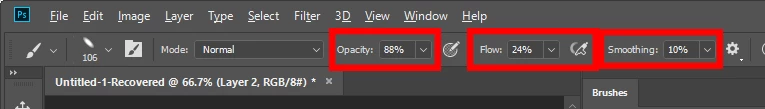

Hi all,
I'm struggling to set value on Brush's Smoothing on Photoshop UI part as below.

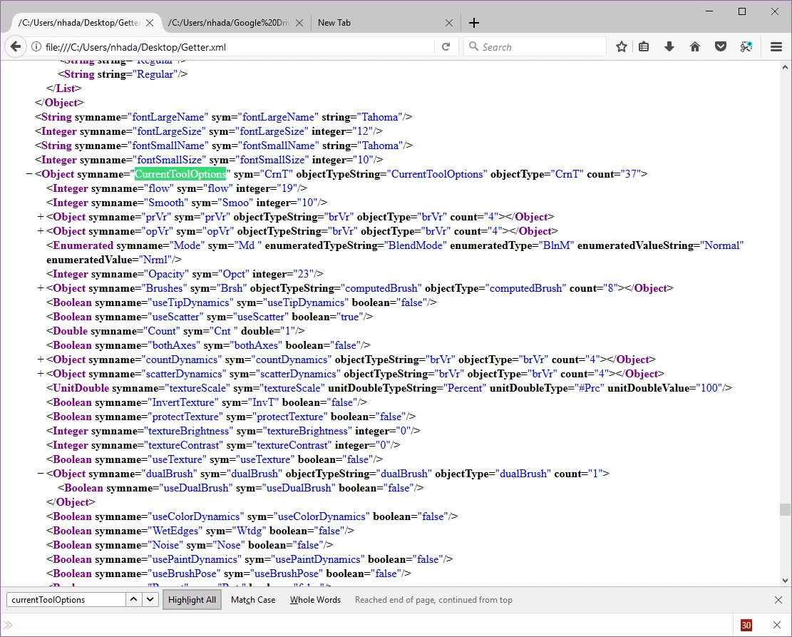

From XTools' Getter.jsx file, it seems Smoothing is exported as following as same level of Opacity and Flow.
XTools: xtools
