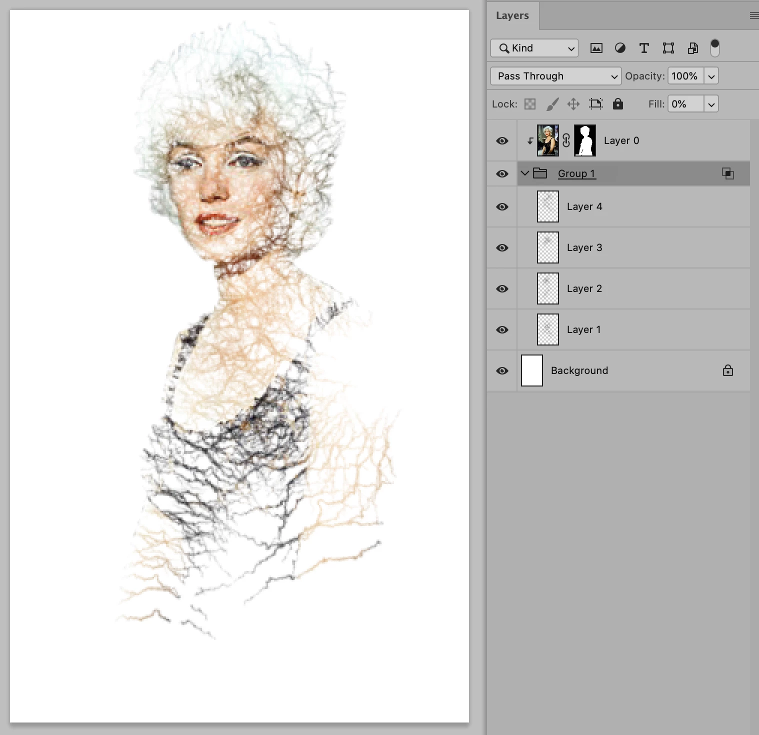

c.pfaffenbichler
March 28, 2020
To add to mglush’c advice one can also Clipping Mask a Layer to a Group, so one could use multiple Layers as athe basis.
And by unchecking »Blend Clipped Layers as a Group« and setting the Group’s Fill to 0% the Layers in the Group itself can be invisible.
But please post the mesh-image or a lores version of it, maybe it would help clarify your point.

mglush
March 28, 2020
Hi!
I think I understand what you want--you want the image to just be visible on the mesh and not the background, correct?
Here is one suggestion: Make sure the mesh is on it's own layer with transparency. In other words the mesh is made up of pixels, and the areas outside of the mesh have no pixels. Then place your image on a layer on top of the mesh layer. and clip the two layers together. You can do this by holding down the Option/Alt key and clicking the line between the two layers in the Layers panel. Then, select a blending mode from the drop down menu at the top of the Layers panel for the top image so that it interacts with the mesh. I would suggest Soft Light or Multiply and adjust the opacity of the image layer.
Let us know if you have any questions!
