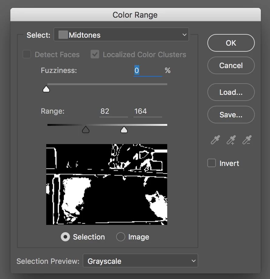

I am aware that when the fuzziness is set to 0%, the selection has hard edges
at 82 and 164 (for the example shown), and as the fuzziness setting is increased,
the range of the image’s tones over which the selection goes from 100% selected
(white) to 0% selected (black) increases.
My question is: What does the slider measure a percentage of, exactly?  Or, to put
it another way, for a given setting of the fuzziness slider (e.g. 33%, 67%, or 100%),
how can I know the image’s tones that are the “first” (on either side of the range
setting) to be 100% unselected?

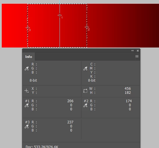

    You can't beat gradients when it comes to working this sort of thing out. So with Fuzziness set to zero we see the vertical line we expect
    Just moving the Fuzziness slider to the right shows how far the selection extends, but does the number relate to anything?
    To work that out, you need a reference point for the initial selection, so drag out a guide and make that your initial selection point. It's actually a bit tricky, and you have to sort of sneak up on it got the zero Fuzziness point right on the guide.

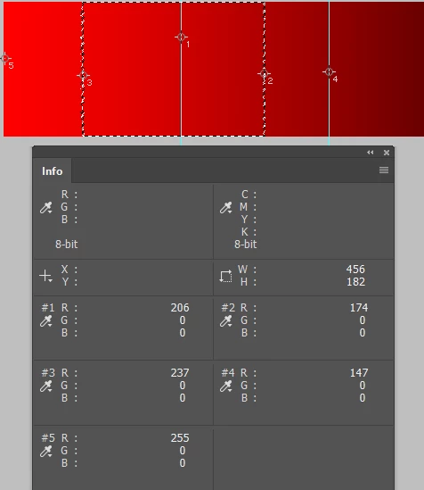

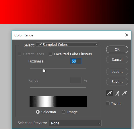

    Increase Fuzziness to something like 50, and OK it.  You can then measure RGB values for the extent of the selection
    In this case the difference is 31 above and below our references, but the marching ants indicate the 50% point.

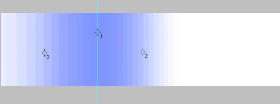

    We can show the full extent of the selection using Quick Mask.  I have set the QM colour to blue to avoid confusion, and turned off the red/black gradient.
    If we drag out guides to the now revealed selection extent, and measure the red content at those locations, we find that the differences are now very close to the value at our initial selection (255 - 206 = 49 and 206 - 147 = 59)  Not perfect, but this was a very much a by eye experiment, so probably close enough to use as a guide.
