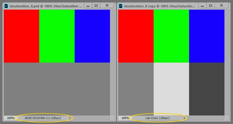

You can do as Myra suggests. If you want the explanation, this is it:
It's normal, although a bit counter-intuitive. It has to do with how RGB data are desaturated - it simply averages the numbers in the three color channels.
The fact that yellow is inherently bright and purple inherently dark is not part of the equation.
If you want to avoid this, you can also convert to Lab, desaturate, and convert back to RGB. Lab works in a different way that takes inherent color brightness into consideration:
