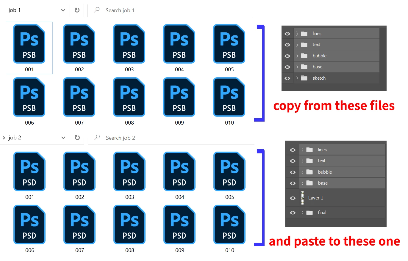

 Hello everyone! I have some jobs that need to transfer some layers. Specifically, they have the same name. What I need to do is to copy selected layers in the files in job 1, and paste to files in job 2 (for example).
I'm new to photoshop so I don't know if there is a faster way than opening each file and copying every of them. If this is possible, thank you for your help and please give me a method that can select the input and output paths (so I can customize it). If not, thank you for taking time to this post. I'm so grateful for all of your help!

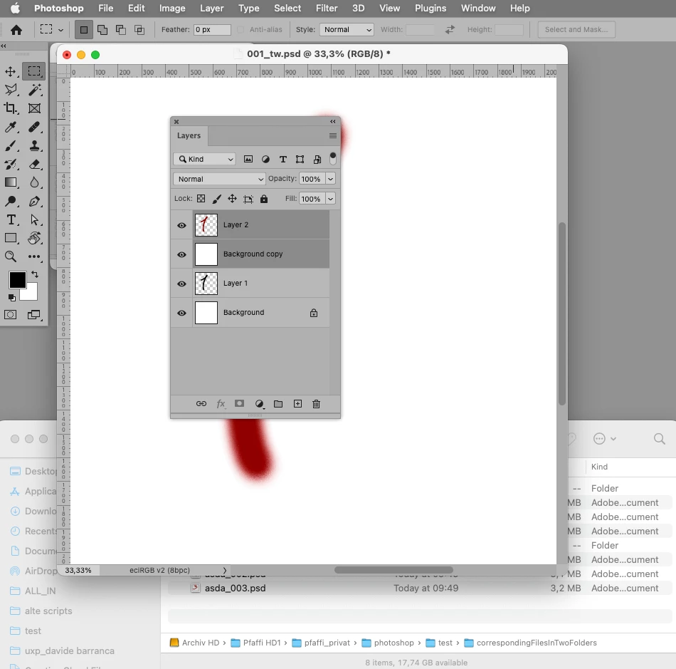

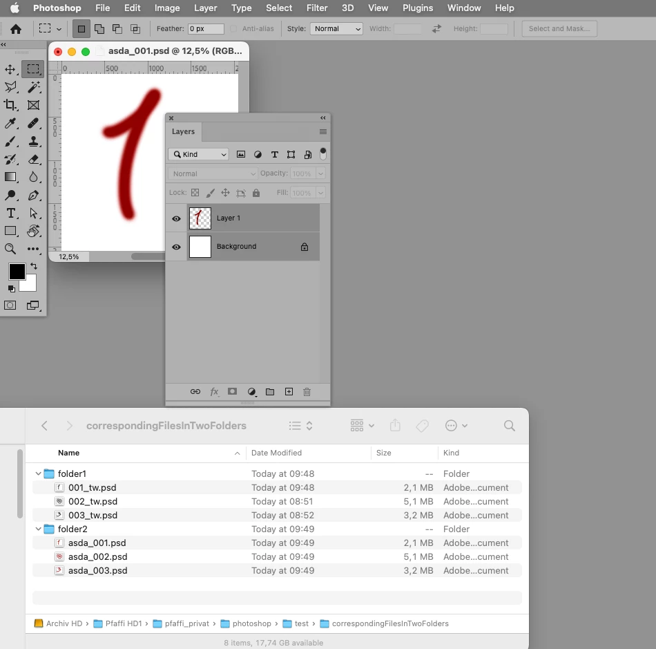

Ultimately the task does not seem interesting enough (or explained well enough) to write a Script for Folder-selection etc. but looking for an image with the same three-digit-number in its name as the open image in a neighboring folder and duplicating all Layers to that should be done with the following.
// if three-digit-number in file name and only two folders side-by-side open image from other folder with same three-digit-number in name;
// duplicate all layers to the second image;
// 2023, use it at your own risk;

Thanks for your reply and sorry for the late reply. However, due to the confidential of my job, it is difficult for me to provide the files. I can only describe with the following clip.
I also really want to learn javascript to script for (only) Photoshop, but don't know where to start or where to learn haha ^^
