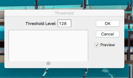

Philipus
PhilipusAuthor
September 3, 2020
Thank you very much Norman for setting this out in such detail, I really appreciate it. Strangely enough, and provided I've not misunderstood, the Threshold layer seems not to work as you describe on my copy of Photoshop. There is no change in the image when I move the slider, except when it goes from 128 to 129, then the image goes from looking completely inverted to looking completely normal. There's no gradual change. I don't see a down-arrow in the dialog box or in the layers panel, so I guess the layer isn't a clipping layer.
[please refrain from PII and 3rd party URLs in this area - Moderator]
Norman Sanders
September 3, 2020
You seem to have missed Step 2:

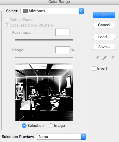

Myra Ferguson
August 31, 2020
Have you tried using Color Range (Select > Color Range...)? You could set the Select dropdown to "Midtones" and adjust the Range to be very narrow.
Philipus
PhilipusAuthor
August 31, 2020
Thanks Myra. When I try that all the sliders are greyed out. Any idea why?
