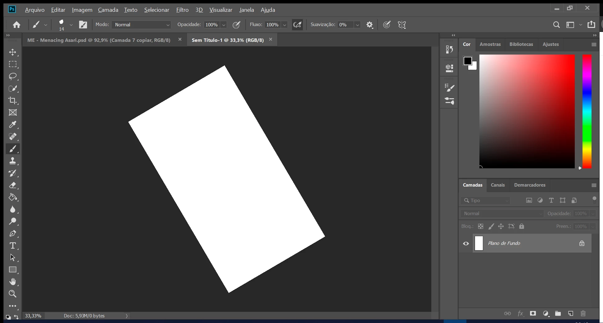

How can I re-center the "workspace" frame of photoshop?
EDIT: I think it's the Artboard, I want to re-center the whole artboard!
I mean, when I'm usng my pen display, I sometimes rotate ...all the layers on screen, but I can't center it back.
I'm not trying to allign an image within the layer space, I want to allign back "the whole thing". EDIT: the Artboard.
Image attached as example, the frame Artboard is tilted, I want it back to portrait position.
Correct answer Michael Bullo
If you have used the Rotate View tool to rotate the canvas, have another tool active and wish to remove the rotation, simply double click the Rotate View tool within the Tools panel.

That's the only way I know of to temporarily rotate the canvas, which is mainly used while painting. So I'm not surprised that another tool would reset it, as they're not designed to work with a rotated canvas.

If your using the rotate tool, hitting esc usually cancels the rotation.
October 20, 2019
I'm not using any tool per se to rotate the image, but when i tried to use this rotating tool, I selected the cutting tool, which... recentered everything, like I wanted : P
I want to know whether there are other forms to rotate the artbnord (I think that's the name of what I want to rotate), but thanks! It resolved.
