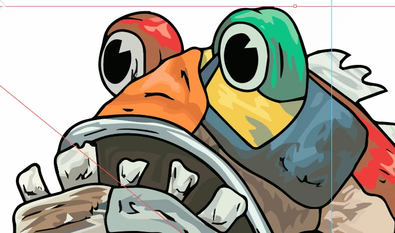

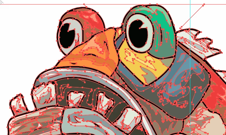

    If you have access to it, I would do this in Illustrator
    You can use Image trace to convert the image into vector shapes which you can then manipulate resize and recolour if required - all with nice smooth vector edges.
    Section before image trace
    After image trace - see smoother vector lines:
    Showing paths :
