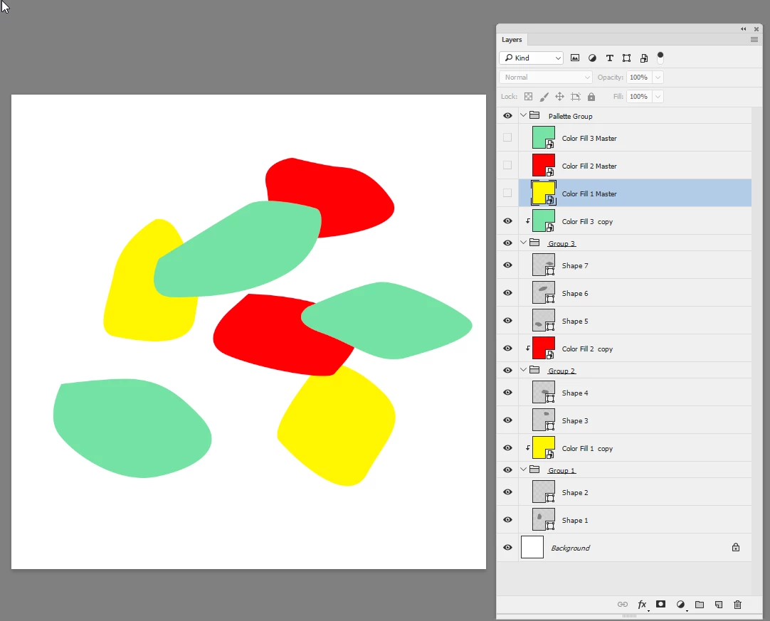

Hi
Photoshop does not have global colours in the way that Illustrator does.
However you may be able to use color fill layers as in the simple example below.
1. I created a document with a few simple shapes
2. I created 3 color fill layers and called these "masters"
3. I put each of those color fill layers in a smart object
4. I duplicated the smart object, containing the color fills, and put them above the layers I wanted to colour - then clipped them to the layers (in the example I clipped them to the groups
5. I turned off the visibility of the master color fill layers
To change color I just open the smart object of the master change it and save. The copies, being duplicated smart objects, are also updated automatically.
Dave
