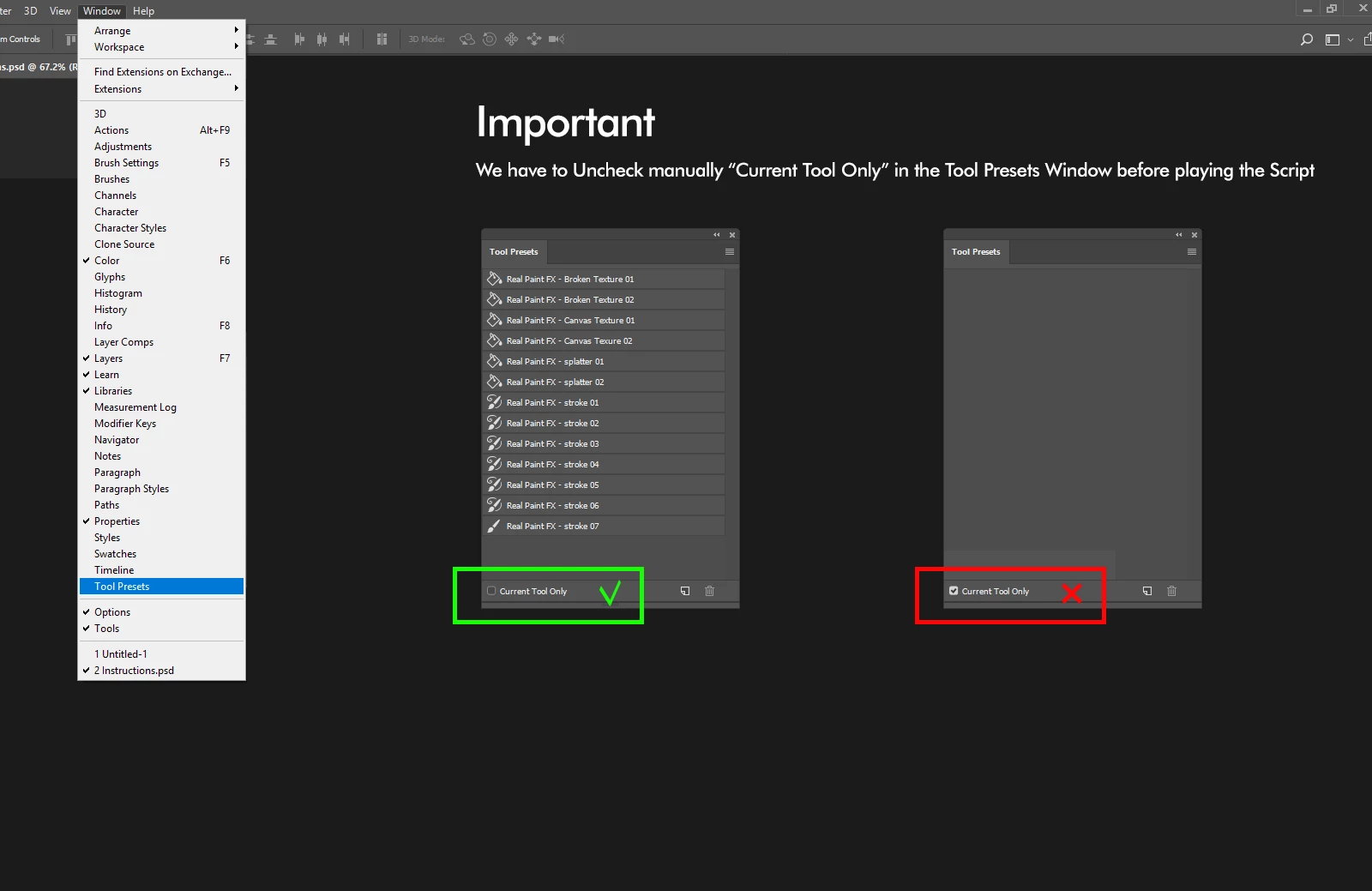

hey guys I can't find a way to record this option in Photoshop. I want my script to uncheck the checkbox in the image
I make Photoshop Extensions for other users and I was wondering if there's a way to add this automatically via Javascript, o the doesn't have to uncheck this option manually before running the script
thanks in advance
Correct answer JJMack
A script can not changet the UI option the not itergace to to that and the Scriptlistener Plug-in records nothing when you do the manually. Therfore it cna not be recorder in an Action so the is noy way to use action manager code in a script to change the ui option.  All you can do in a script is to use action manager to select the tool you want to selet a tool preset for the select the tool preset you want to use.  The code is in my Cycle Tool Presets Package

thanks a lot JJMack for the prompt answer, is very cool that also the Tools can be loaded iif in the Scripts folder.
All useful infos!
