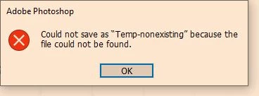

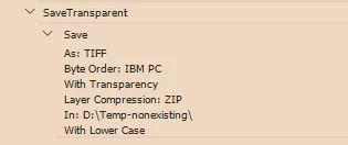

October 30, 2023
I now tried the third alternative, but it looks a bit differenct in my action, as the folder name (I named it temp-nonexisting) shows up (as it was when it was recorded) and I get an error message when running the action (and it seems as the other save settings were not performed).
How did you do in order for the recorded action to turn up as "In: File or folder not found"?

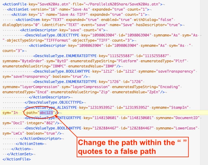

On the Mac, without using Windows, I did need to use xtools:
.../xtools v2.3/apps/ActionFileToXML.jsx
Save the updated XML file, then:
.../xtools v2.3/apps/ActionFileFromXML.jsx
You can download my (new) version here:
https://www.dropbox.com/scl/fi/nr70u8c579rhjrbwob9g3/Save-As-TIFF.atn?rlkey=2frrsz1kz6x8elruwfl7usg4v&dl=0
Many thanks!
