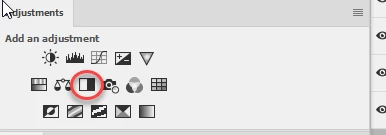

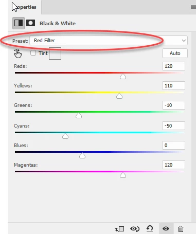

You can adjust individual colors during the conversion to Black and White if you convert using a Black and White adjustment layer.
If you go to the top of the adjustments there are presets including "Red Filter" to act as a starting point
Dave
