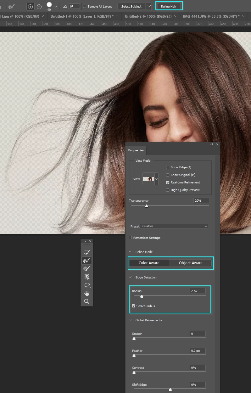

Some situations are just not possible to get a really good result from. If your image has a busy background with lots of fine detail with lots of different colours, then that might be why Select and mask is not working well.  If that is the case, try the image below
Do you have Select Subject set to Device or Cloud?  If the former and you have a half decent Internet connection, try setting it to Cloud.  It takes a tiny bit longer but does a better job.
In Select and Mask, do you have Refine Hair checked?
What are your Refine settings?
Try both Color Aware and Object Aware
I usually use about 2 pixels for Edge Detection and have Smart Radius  turned on.
IME It is definitely possible for Select and Mask to get its knickers in a twist when nothing seems to work.  Make it a last resort, but if think you have tried everything and are getting nowhere, try resetting Preferences

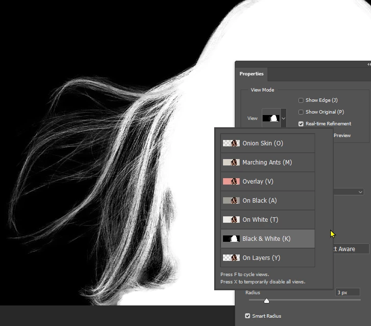

The Black & White View mode is good for flyaway hair as it gives you the best indication of how your selection is looking, and definitely helps you home in on the best settings.  i.e. in the example below, I found that increasing Radius to 3 pixels made a small improvement.  If you mess up and get a big clumpy mess, I prefer to Ctrl Z back to before things went pear shaped rather than push on and make a bad situation worse.  Whatever works for you, but there are all these options, and I have a feeling most users never try them.
