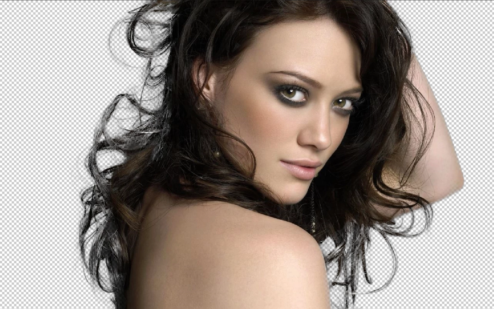

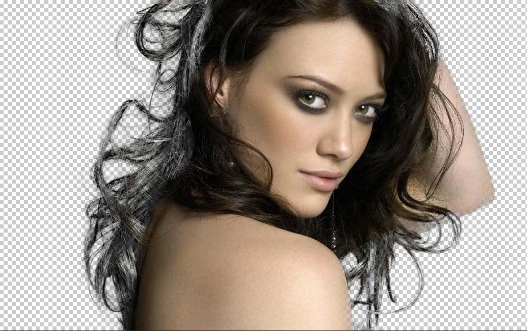

    I have now also tried to mask the portrait (apologies to the copyright holder!)  I get very similar results when viewed in Photoshop, but which look much better when saved as a jpg
    Below is a grab of the screen when in Photoshop, some of the models hair is very transparent
    Saving as a jpeg produced the following
    The hair looks much better

    That's a really nice mask. A lot of hair looks transparent when cut out and if you look at a strand of real hair it is semi transparent-so it is bound to look strange if you punch holes in it. A good trick is to increase the density of the hair by duplicating the masked image and using 'multiply' mode . You will find by adjusting opacity the hair looks more solid.

    I think that is one of the differences we see between the old refine edge and the new (aside from the odd strange selection area artefact ).
    The old seems to give a softer mask and the new a much more "contrasty" edge. The tip in the guide Trevor linked was a good one - to put the image against the new background whilst masking.
    PmPhotographic mentioned issues with decontaminate - I rarely use it - I don't think it works well. Brushing colour on a separate layer is much more effective.

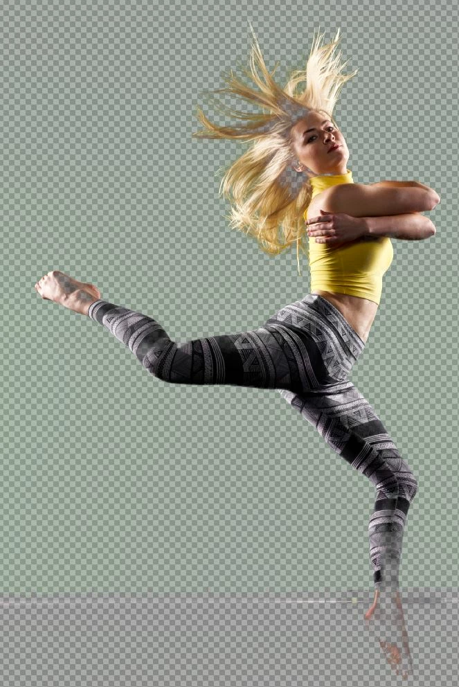

    Well, at least its not just me....  I've also just been trying to mask out some head shots, and like you just can't do it.  The select tool now can't tell the difference between a green background and a highlighted blond hair.  The refine edge tool at times seems to do nothing as far as I can tell, but sometimes works.  Also, the view modes do not always seem to work, both 'onion skin' and 'on black' have at times shown the original image, rather than an extracted one
    Edit, I found that if I selected 'black and white' that the refine edge tool worked well.

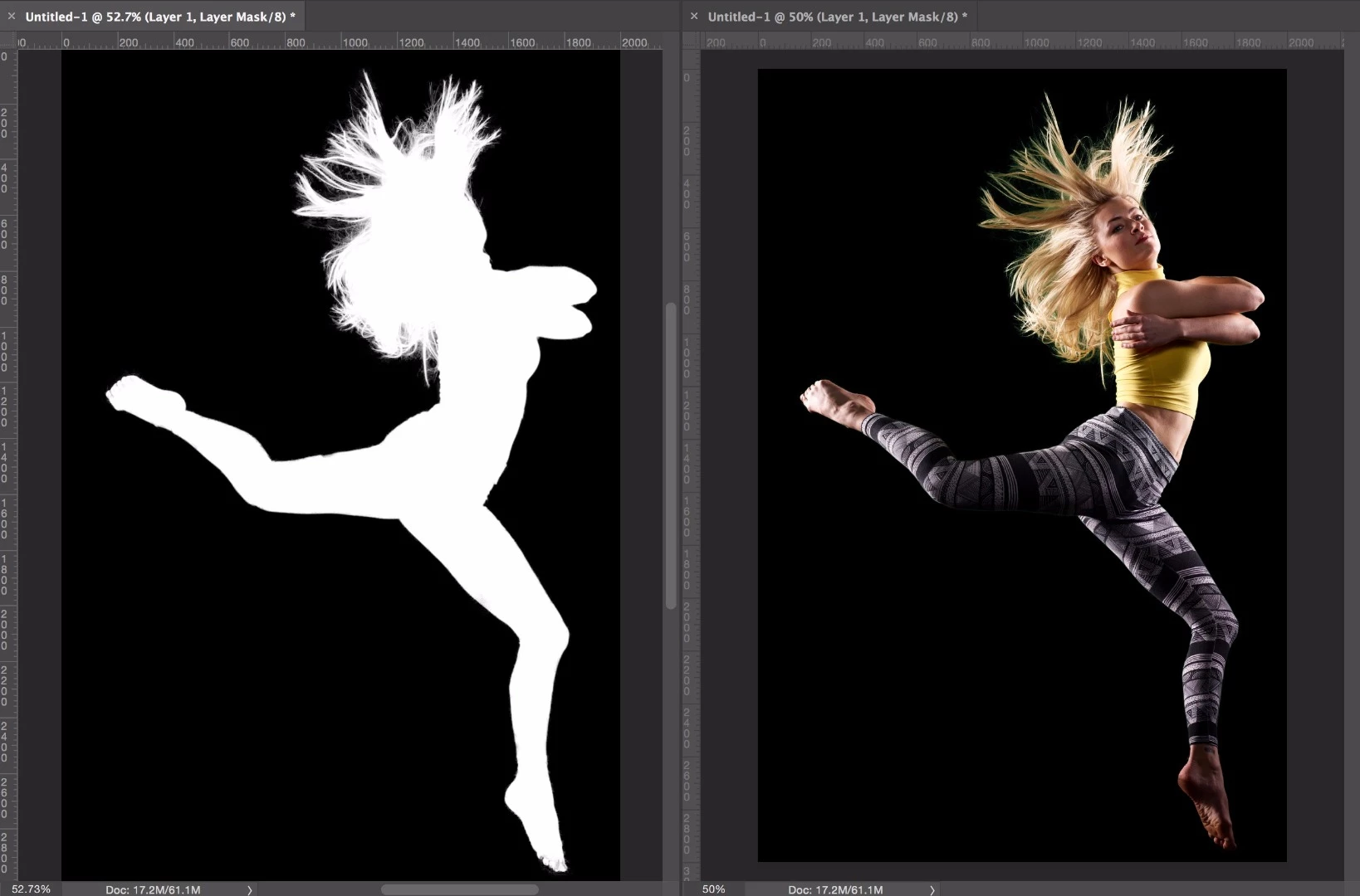

    I just wanted to add my results with these images, each one took me around 5 minutes to complete. This was all done using Select and Mask from start to finish. It looks like my results were quite a bit better than what you were able to come up with. What is your selection workflow PmPhotographic?

    I think one step that might be helpful, that perhaps is being left out, is the ALT/Option + click with the Quick Selection tool to specify which areas are to NOT be selected. Such as the background and green around the dancer, or the gray background of the model.
    Does this help improve initial quick selection results?
    Workflow would be:
    1. Start with no selection
    2. Open select and mask
    3. (with quick selection tool selected) Option-click the area to NOT be part of the selection
    4. Then start +brushing with the quick selection tool to select the subject.
    5. Use refine edge brush around the edges of the image and over parts of the hair. Note, adjusting the size of the brush can be helpful here. I usually put about HALF of the brush cursor edge within the subject's edge, and HALF of the brush outside of the subject's edge and follow that edge-line where needed.

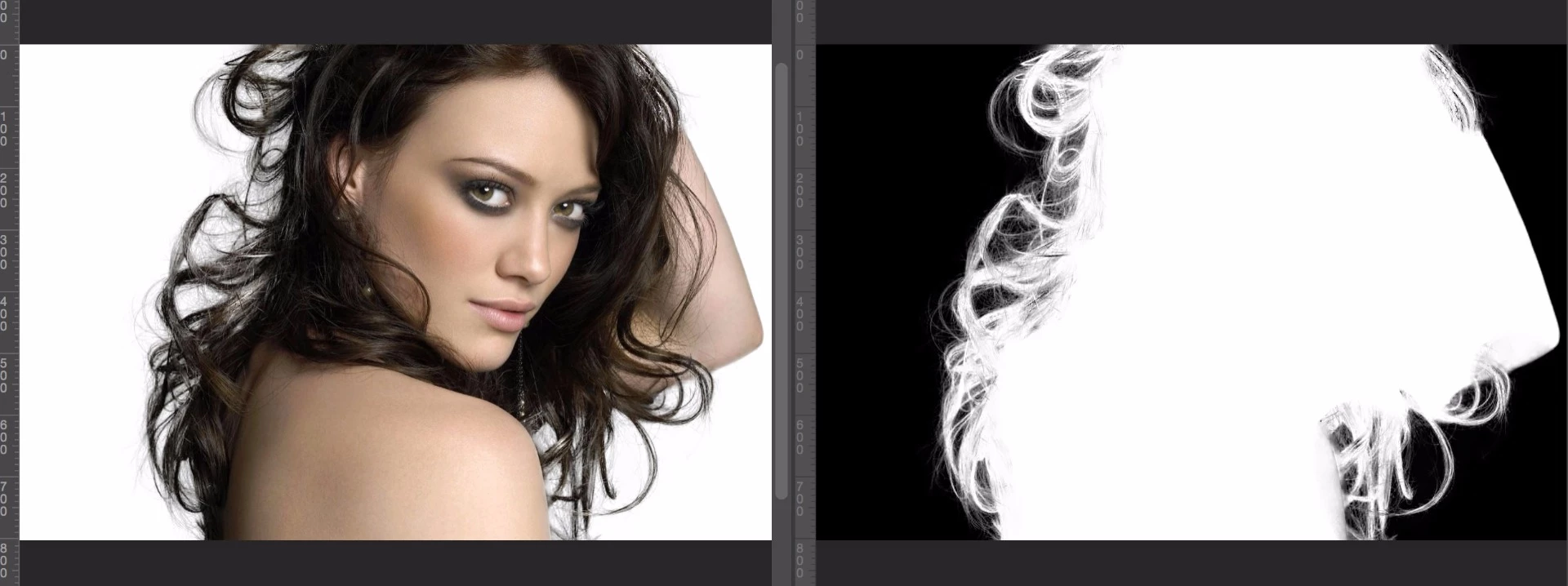

    Not an image that works well with Select and Mask, although with a nice grey background you'd expect it would.. This is what I got after about 10 minutes with some additional steps-far from perfect. Probably with more time invested it could be improved but far from ideal.

    Thank you Terri, for talking the time and mask the picture with your system.
    yes, select and mask tool is far from perfect, but the transparency bug is a real deal breaker.
