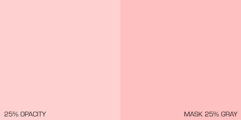

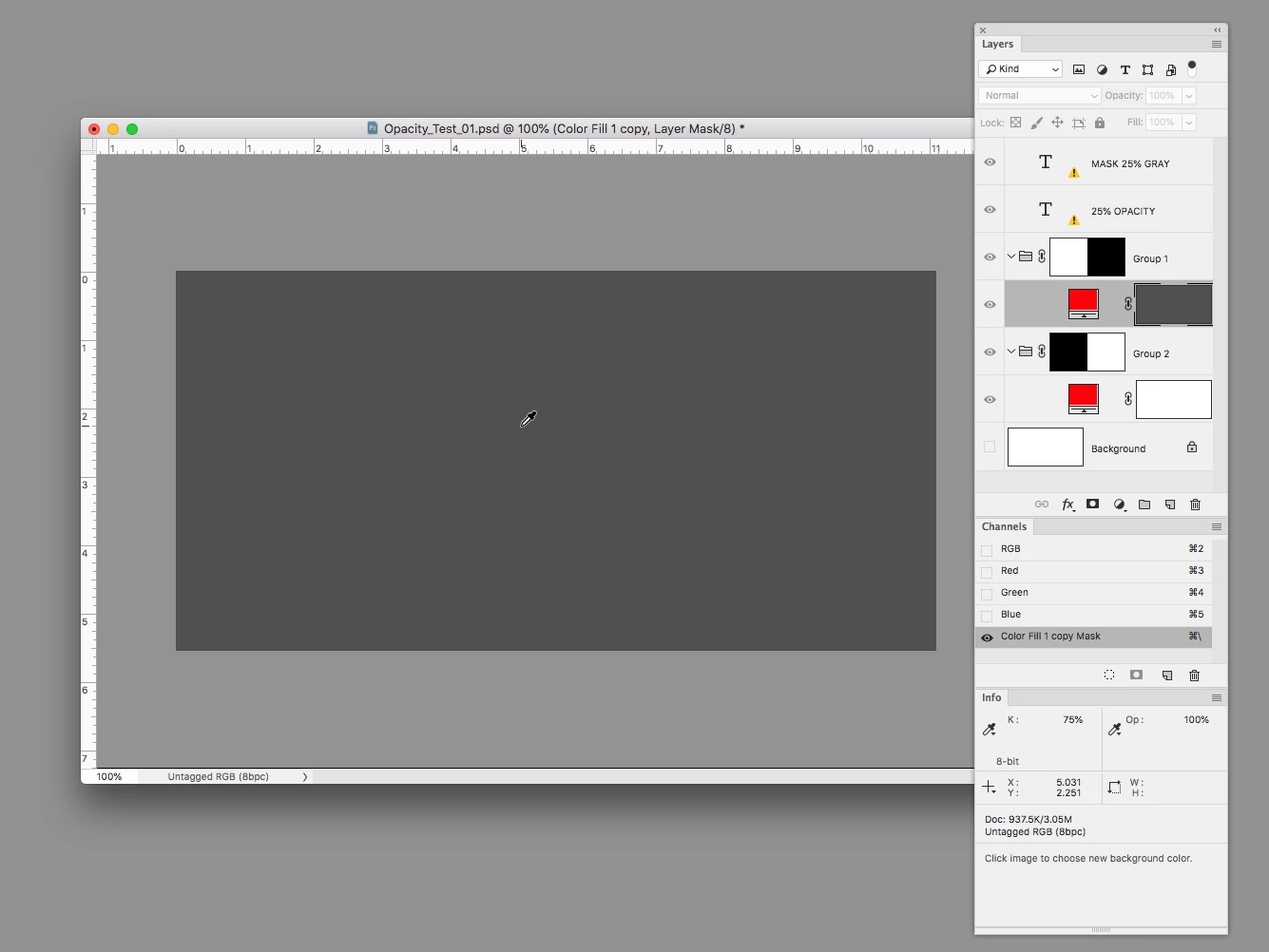

    Here's a comparison. The left side shows a red layer on top of a white background at 25% opacity. The right side show the same layer with 100% opacity but a mask filled with 25% gray. As you can see, the mask version is darker.
    You can download the PSD-file here ... http://www.andreasresch.at/upload/Opacity_Test_01.zip
    I also tried the L value of the LAB mode, but it doesn't work either.
    Cheers.

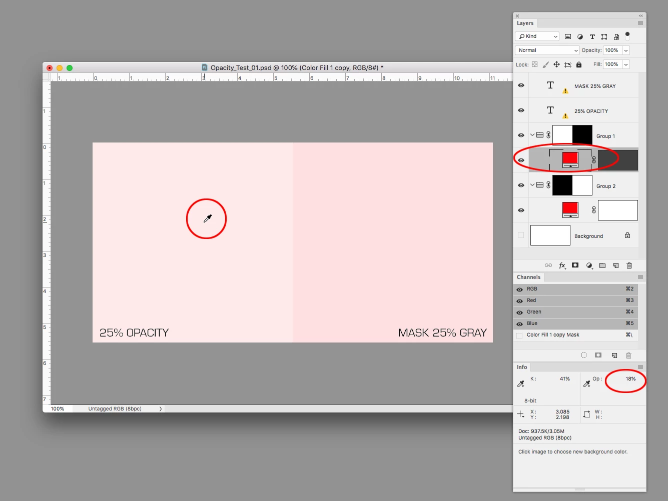

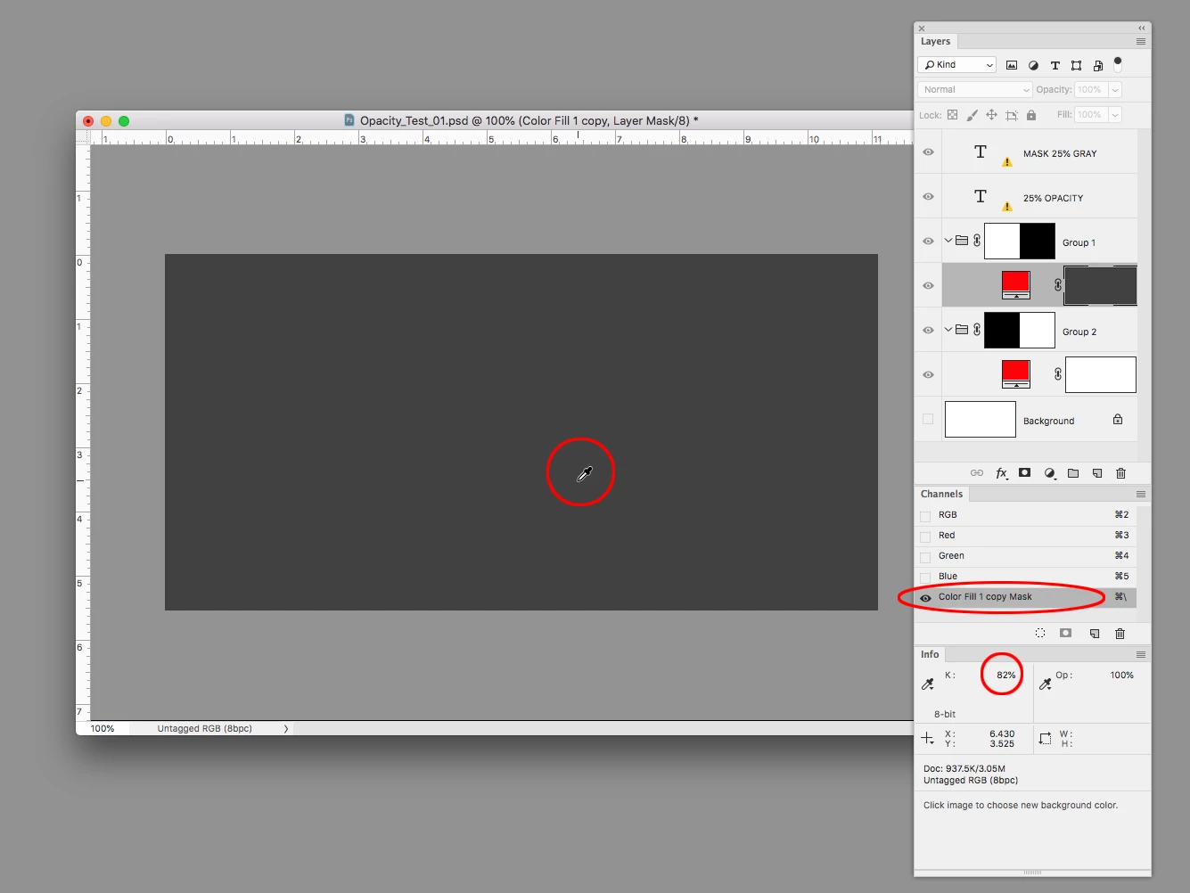

    If you check the gray value of the layer mask it is 82% (Option-Click the mask thumbnail):
    That makes the Opacity 18% (100-82). Note that I've hidden your background layer, which is at 100% in order to get the layer's Opacity reading from the Info panel:

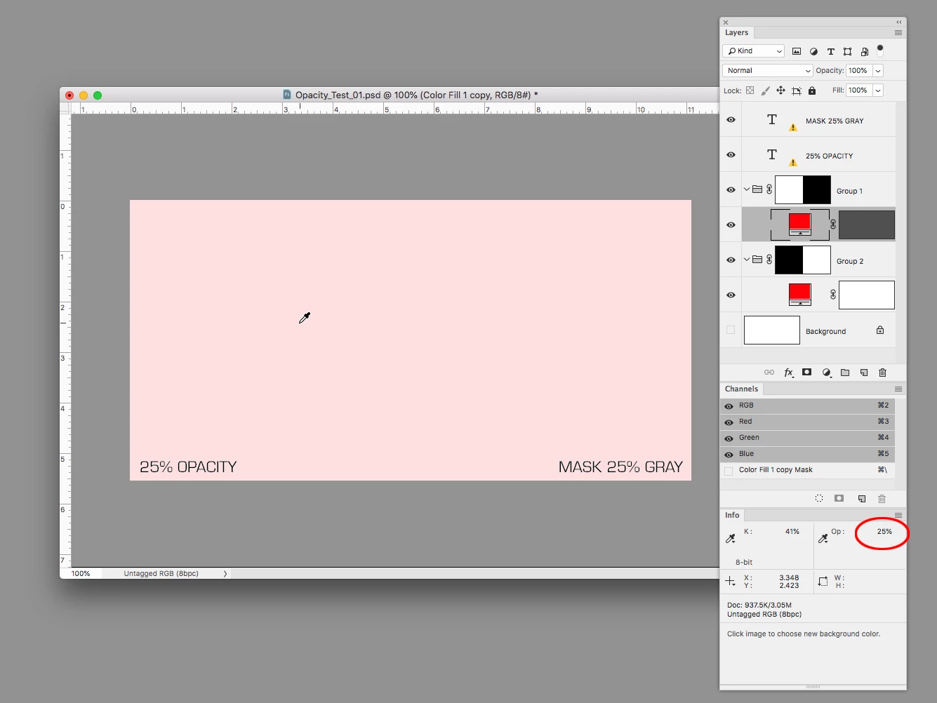

    If I adjust your layer mask's grayscale value to 75%, the Opacity will change to 25%:

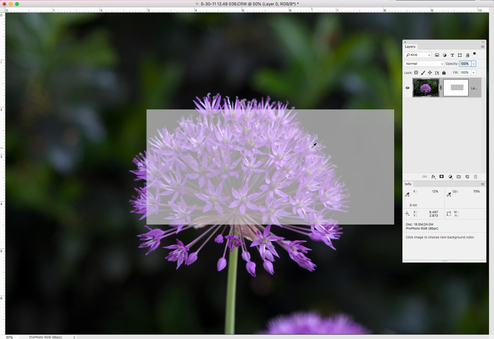

    How are you measuring the values? I think Opacity should be the inverse of the mask's gray value (100% - K%).
    Make sure you target the layer art to get the Opacity reading, and then the mask to get the K value.
    Here I'm targeting the layer art, and the Opacity reading is 75%, while the K reading is 12%. But the layer art's Grayscale reading represents the conversion of the art's sampled RGB value to grayscale, and not the mask's gray value:

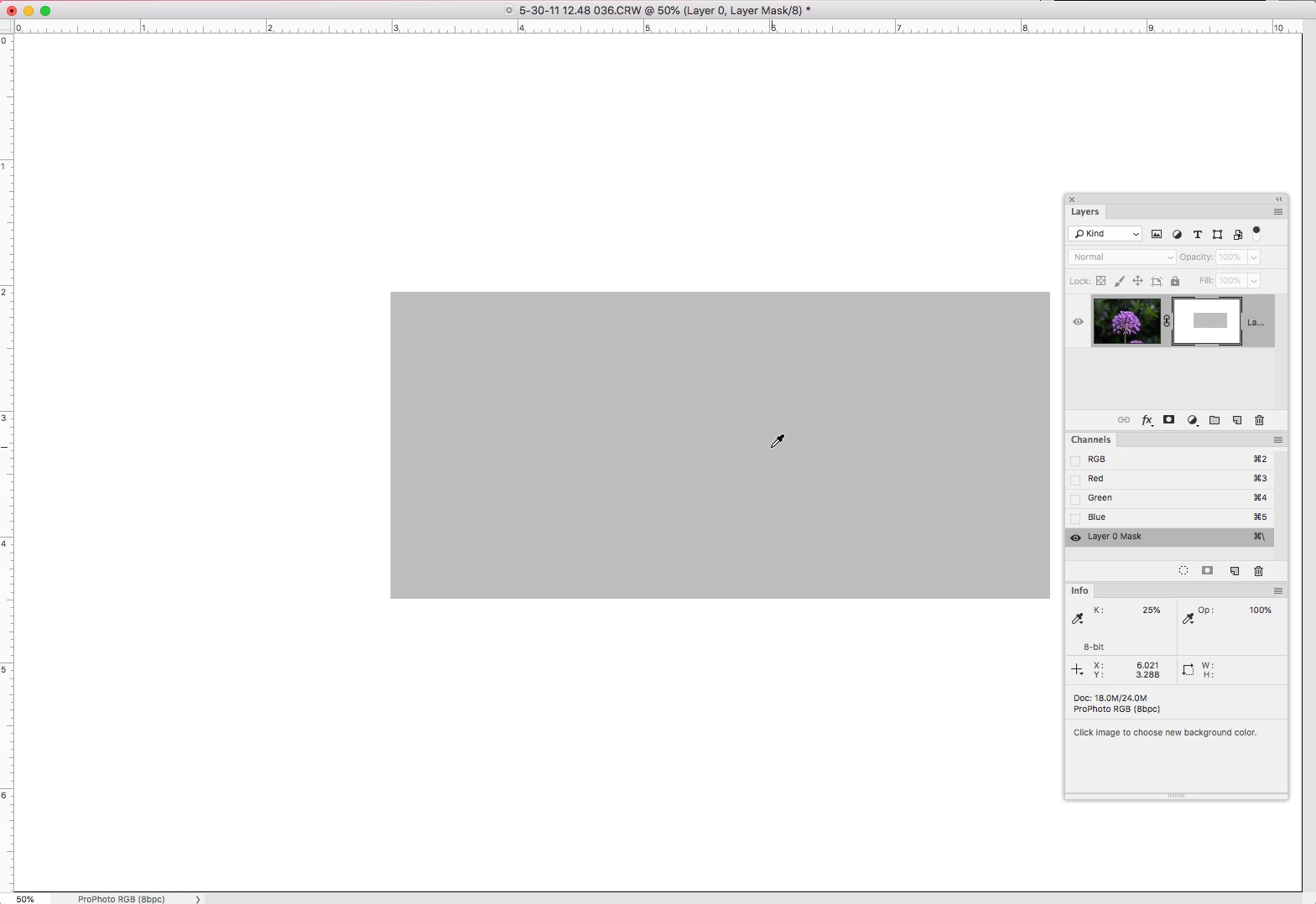

    If I target the layer's mask and take a reading, the mask channel's actual gray value is 25%, or 100%-Op%:
