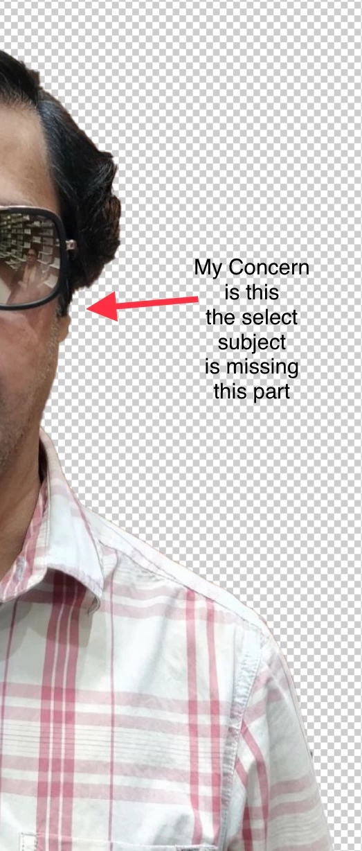

Please check this attached screenshot, The stations that I am doing is, I am uploading the photo and then running Select Subject Tool so the select subject tool is missing certain portions of the Ear as you can see in the already masked image and besides that is the how the original looks.
I have done this on the iPad Pro. Same happens on the Desktop Version aswell.
 What can I do ?
 Thanks

Use Select subject then refine with select and  mask to create a good mask to remove the background well. For Remove background did  an unacceptable removal on that image.
