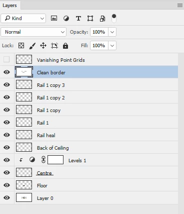

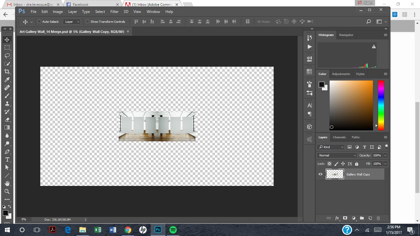

    The technique for blending will vary by content and how you have merged them - can you show an example.
    Also show the layers panel which will help us understand how you have merged them (i.e. do they overlap and have you used masks)
