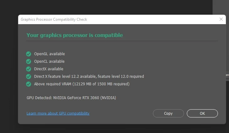

Ah, you are in release Ps, not beta. This is the beta chanel so we will move this to the Ps forum.
August 3, 2023
the removal tool works in (beta version of PS), but works in PS

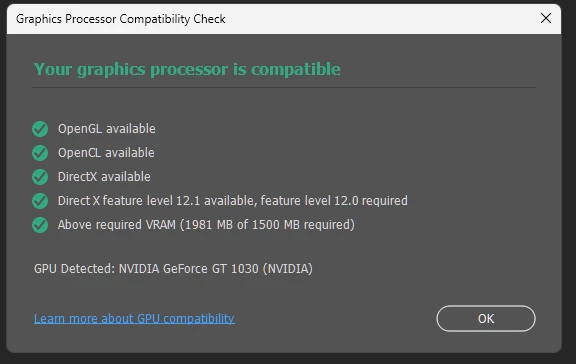

@CShubert regarding the GPU compatibility check, everything is okay. I attached a screenshot of that as well.

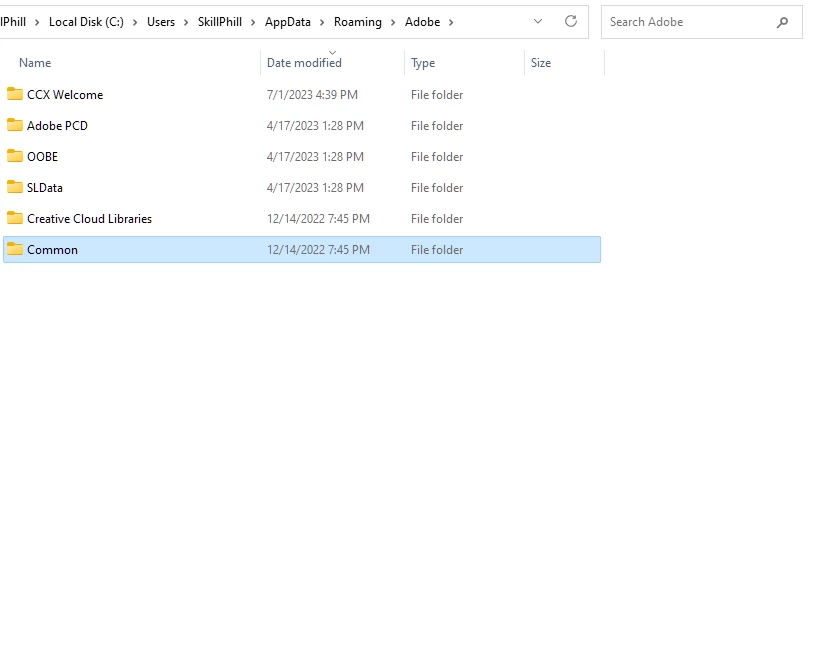

Hi @CShubert,
I wasn't able to manually replace preferences because I am not seeing that folder at the address you gave. I'll attach a screenshot.
The remove tool worked after pressing and holding Shift+Ctrl+Alt (Win) and opening Photoshop. Upon restarting, without that button combination it does not work.

Hi @PMcKenley we want to make sure we understand where things are:
You manually replaced your prefs and restarted Ps and the remove tool worked, is this correct?
You then shut down the computer and upon restart, the remove tool did not work?
Let's make sure the computers GPU is up to spec:
https://helpx.adobe.com/photoshop/kb/troubleshoot-gpu-graphics-card.html#multiple-gpus
