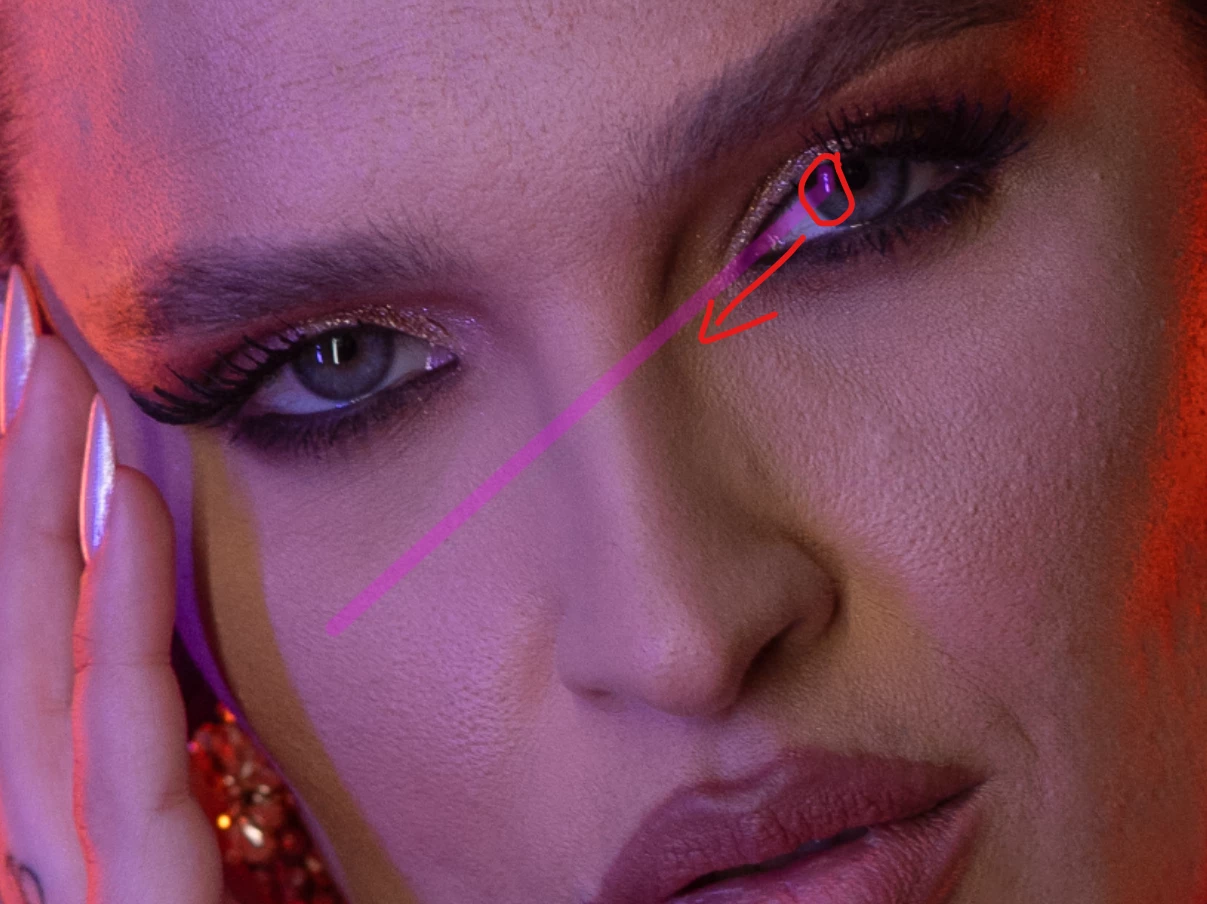

I have encountered a unusual issue with the Remove Tool in Photoshop since version 25.0. This problem did not exist in Photoshop 24, and despite reinstalling all Adobe apps, the issue persists.
Bug Details:
  • Version Affected: Photoshop 25.0
  • Issue Description:

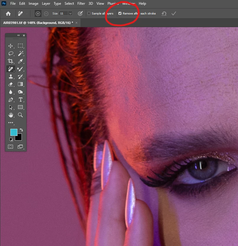

    • The Remove Tool initially works as expected for a few strokes.
    • Afterward, it starts behaving as though the Shift key is being held down.
    • It no longer removes after each stroke and instead begins drawing straight pink lines.
    • The issue can sometimes escalate into erratic behavior.
Steps to Reproduce:
  1. Open Photoshop 25.0.
  2. Select the Remove Tool.
  3. Use the tool for a few strokes, observing normal behavior.
  4. Continue using the tool, and notice the shift in behavior as described above.
Additional Information:
  • This issue persists despite a complete uninstall and reinstallation of all Adobe apps.
  • All other functions in Photoshop seem to be working fine.
Is anyone else experiencing this glitch, or is it unique to my system? Your assistance in resolving this matter would be greatly appreciated.

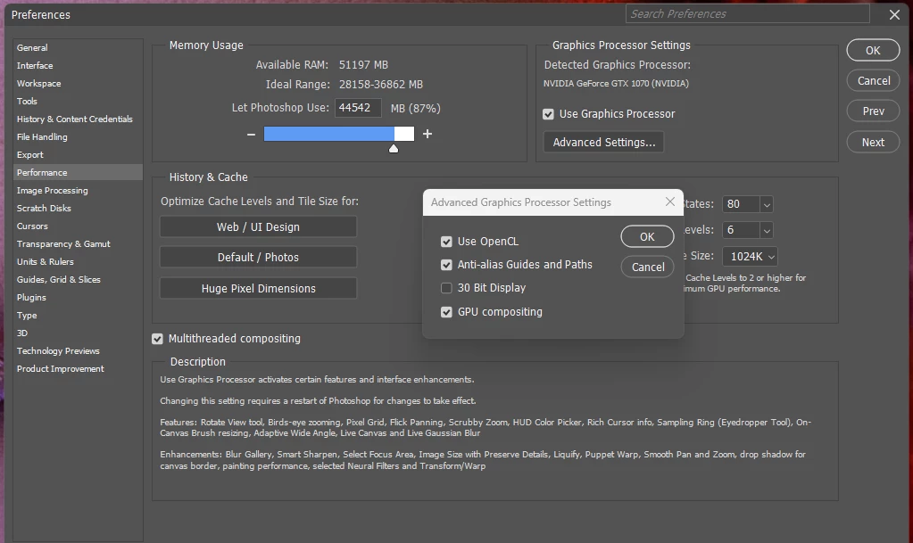

in the settings i already disabled "using graphic processor" and
the settings for the remove-tool are "stable".

I've experimented with various options, and the result remains consistent. However, when I disable the Graphics Processor, the Remove Tool functions correctly. Yet, this action causes the CPU to reach 100% usage, leading to a noticeable slowdown in the overall performance of Photoshop

Thanks for the comprehensive video and screenshots which allowed me to try the same settings.
I couldn't replicate that here. When using cloud processing I started to see the odd occasion when the drawing of the pink lines did not appear immediately, which in turn then delayed the removal, but could not create the straight pink lines you show in your video.
