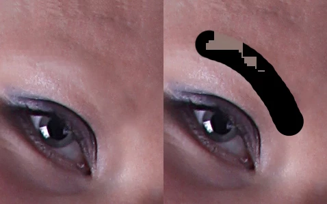

Remove Tool Photoshop 24.6 / 24.7 bug
  • August 2, 2023
  • 204 views
The above photograph shows what happens when I try to use the remove tool to remove an eyebrow using Photoshop 24.5 (left) and Photoshop 24.7 (right) The problem was also the same when I used Photoshop 24.6
I have tried resetting the tool, reinstalling photoshop (multiple times) and 'Reset preferences on quit' all to no avail. I have asked other Photoshop users if they are having any trouble and they are not. I appreciate any help anyone can give me.

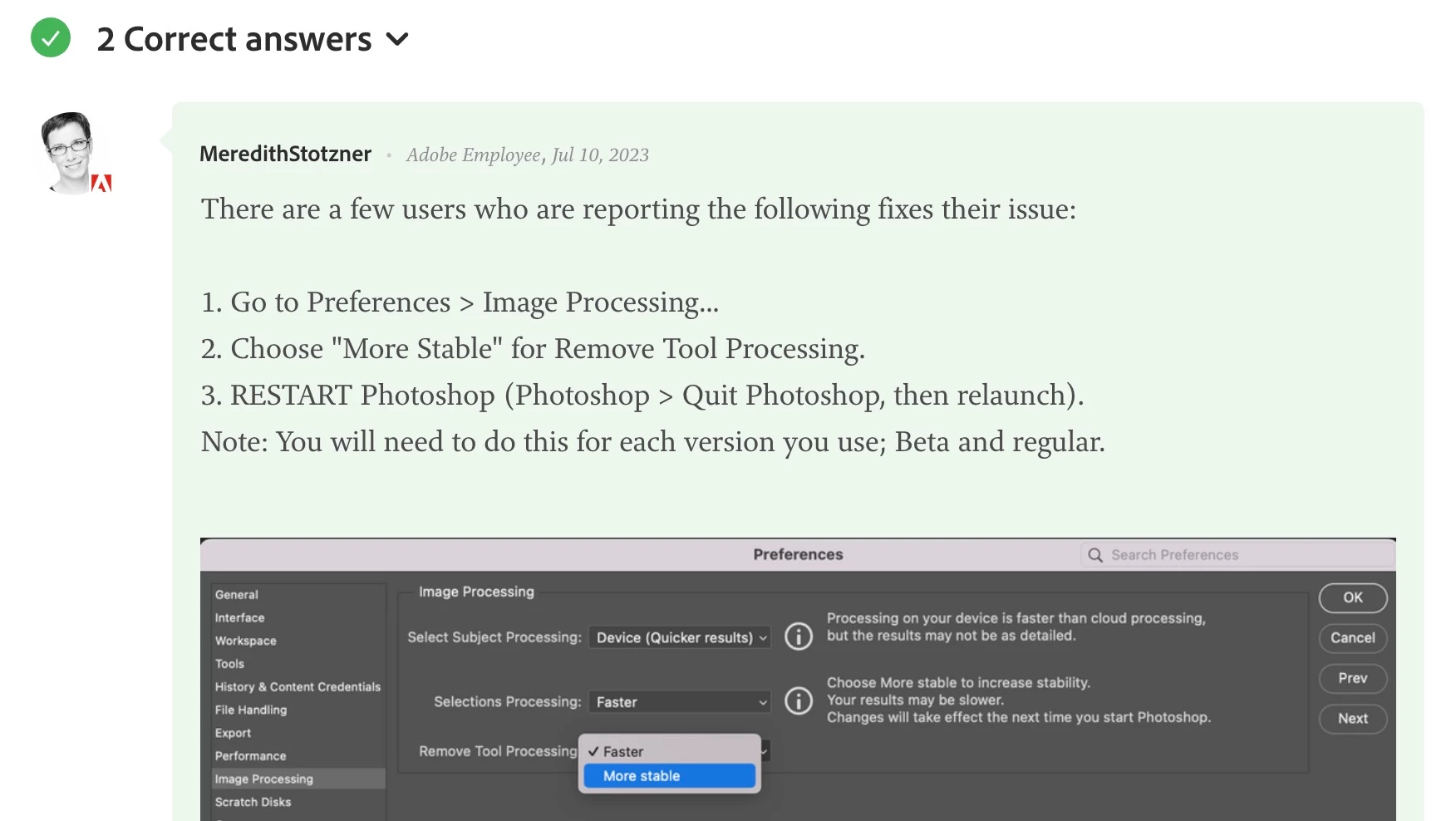

Correct answer DavidfromScotland
Since posting this, I have since found an answer from MeredithStotzner.
DavidfromScotlandAuthorCorrect answer
August 2, 2023
